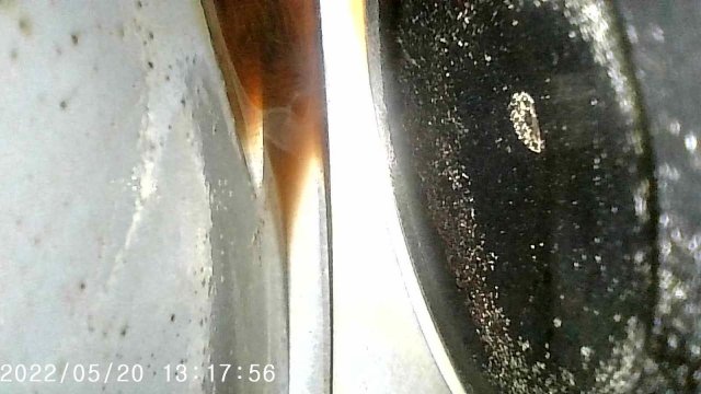

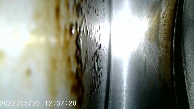

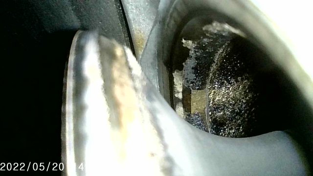

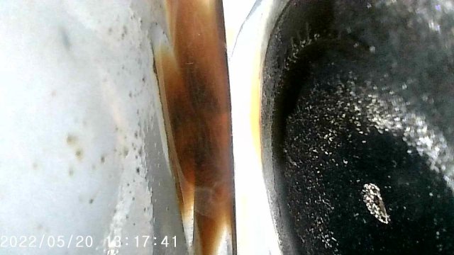

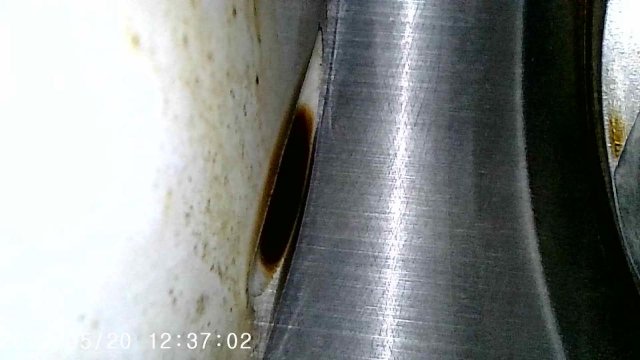

im going through some stuff right now…
Not blaming installer or builder. Just want it fixed. I think I'm cancelling the rest of my travel for the year and racing events. Kind of at my limit mentally.
Ignore time stamp as my boroscope doesnt keep time.

New engine rings not seated?
4,129
10,396
Thread Starter #1,566
I dont know but that valve is fubared
8,741
7,675
sounds a little tight yeesh
3,812
9,031
Piston to valve clearance not enough or cam installed incorrectly? There’s why she loped so much? Sorry to hear, you don’t have good luck much do you.
8,741
7,675
How does a valve get burnt so quickly
8,741
7,675
really sorry to hear about your bad luck man, hopefully builder makes it right

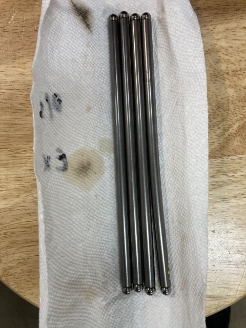

I had that cam bent push rods

That wouldn’t cause oil in the combustion chamber though. Ring gap had to of been junk and judging by the huge slow lope there was probably horrible compression because of the rings

aren’t those supposed to be new heads? There’s so much carbon buildup behind the valve I don’t understand how that can happen with just a few startup miles if that
