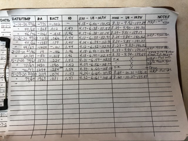

You should add DA & a comment section on your chart for comparisons from pass to pass & any changes that you make.

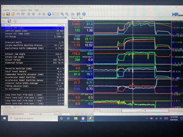

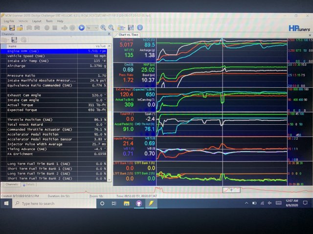

Forgot to review the logs. Looks like in a few places Tq is dropping off. Correlated items are Inj duty cycle hitting close to 100%, spark dropping. Wonder what the culprit is.

Good deal, adding the DA, I also have temp & humidity on my hand written chart. Humidity is one of the biggest factors for good ET's & DA is a # of all the factors together.
-1424 DA are you kidding! I see B Mason in Texas going out with -1000 DA and better all the time in the cooler months. Best I have seen in Michigan in the last few years is -500.
