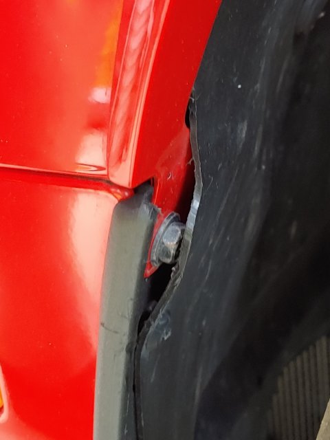

10,561
29,808
10,561
29,808
10,561
29,808

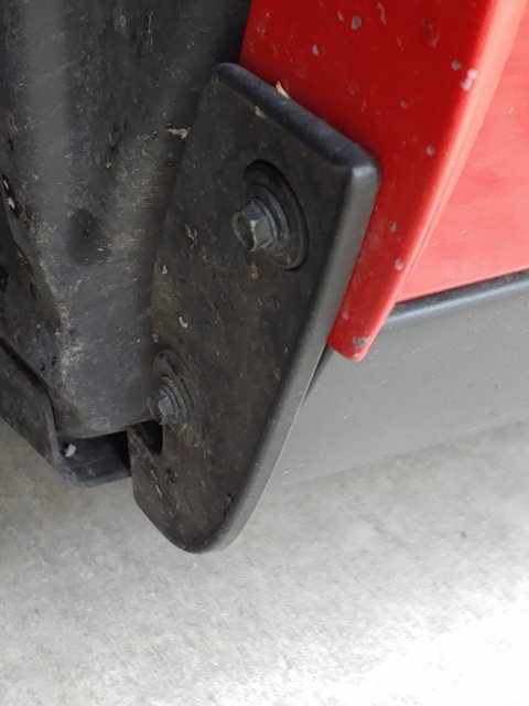

10,561
29,808
Rear bolts

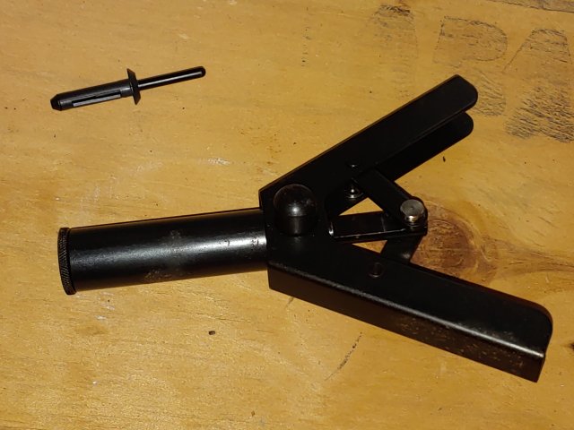

10,561
29,808
Tool

And an installed rivet.
