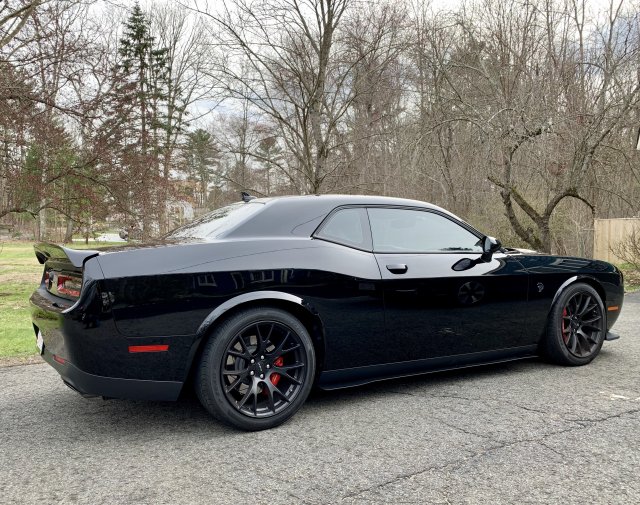

Here's some new pics of mine I took today. Sun wasn't fully out so it was a little overcast. Tomorrow's weather looking cloudy all day so these will have to do. View attachment 14782
View attachment 14784 View attachment 14785 View attachment 14786
It looks aesthetically real good. It could be because you are using 335s it did not hit the fender on bumps with passengers and/or stuff in the trunk. Did you put the mud guards on without drilling into the flare for that upper screw? Just don't go to 345s.

I didn't use the top hole on the rear ZL1 splash guards. I used 3M double sided tape there to stick them to the flares. I had originally thought about going with a 345 after the 335's wear out but now I don't know. It would be nice to have the Michelin PS4S which they don't make in a 335, but there's not really any more tread width compared to the 335 Michelin PSS, the 345 will be slightly taller though and have more sidewall bulge, both of which I don't really need. The 335's seem to have the right tire height for the look I want and they already max out the width I have available with the fender flares. Sucks there aren't more tire choices, Michelin isn't cheap. Would love to have a Continental ExtremeContact Sport in a 335, but they don't make one in a 335/30, only a 335/25 which is a really short tire and I would have some fender gap.

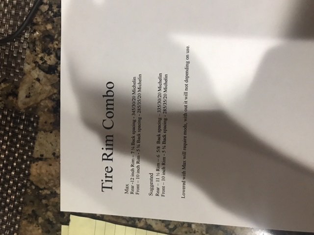

I presently have a 10.5 on the rear and 10 on the front. I discussed wheel and tire options with Bill @phillips performance and he agreed a that a 315/35 is not a problem with plenty of room. I already have Nitto’s 315/35 for the rear on order.
He also recommended the combinations below.

I presently have a 10.5 on the rear and 10 on the front. I discussed wheel and tire options with Bill @phillips performance and he agreed a that a 315/35 is not a problem with plenty of room. I already Nitto’s 315/35 for the rear.
