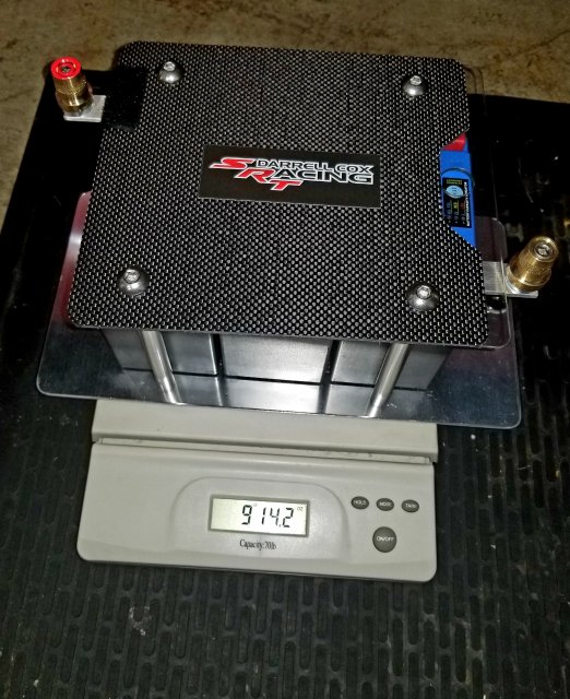

Wow, as usual, looks like @DRAGRCR took it to another level when I just looked up his battery. Again, just wow! https://braillebattery.com/products/i49ce-1
Just so you know, I would not buy that battery again. I had a really good tax return sitting there and wanted to get something for the Demon. I 100% would buy the COX battery right now if I was in the market for one........
Now you know why I went out of my way to swap my battery into my Buddy's Hellcat just before selling the Demon. And now we swapped again so he has my new assembly line battery from the RedEye and I have my Braille back. No way did I want that battery to go with the Demon because the people buying the car did not need or appreciate having it.
I did run that battery down in the staging lanes at Famoso on a hot day. I had enabled the after run cooldown system and was not paying attention as I made several moves in the staging lane because it was really long/crowded. Each time I moved the car it kicked off another 5 minute run cycle.
NOTE: And Pay Attention. The permissive for the battery condition being good (green check mark), to run that system is DISABLED with a Lithium Ion Battery. This is because of the Lithium Ion's higher voltage and the fact that it maintains it's voltage until the VERY END ! ! !

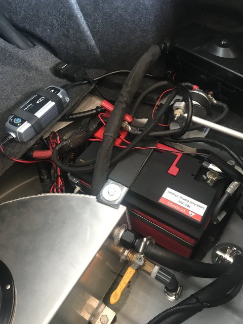

Is there a recommended trickle charger to run with the DCR battery? I see they have one on their website, but I wouldn't want one permanently attached to my car. How long can your car sit before the battery would be dead? Mostly I just drive my car weekends (Also stored in winter).
Octanewide
#988
1,131
2,147
House of power
@Octanewide
I have had this charger for over a year now. I use it in the winter 100% of the time as my Hellcat sits in hibernation. I have it mounted next to where the car sits and I installed the quick plugin that comes with the charger under the hood. During the driving season it's not on the charger much and I've never lost a charge on that battery.
CTEK (56-926) LITHIUM US 12 Volt Fully Automatic LiFePO4 Battery Charger https://www.amazon.com/dp/B00EUF6UM8/ref=cm_sw_r_other_apa_i_CBITEbPM72QTM

Here is the underhood charging hookup for that ctek charger.
