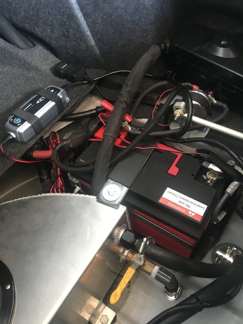

I’ve had one of the Arc Angle’s in mine for some time now. It saved approx 30 lbs and cranks the engine like its on steroids. Much stronger then the OEM. It’s a full size drop in replacement. I haven’t experienced any downside and it has a 10 year warranty. A stock lead acid battery doesn’t last that long so what’s to loose? 9BA942FC-25FE-4C9B-B35E-487B24ECFB39.jpeg 8B154C2A-4E23-4448-8B6F-8D7CD04E2CC1.jpeg

^^^ I have the same, & traction is the same even with less weight in the back, these cars are so heavy so can't hurt it with less weight.
