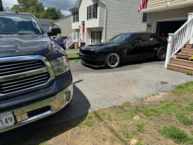

hellcats bitch ass got the boot. Tired of working outside. Btw new hellcat theft deterrent. Ram 1500.

Man she’s shiny

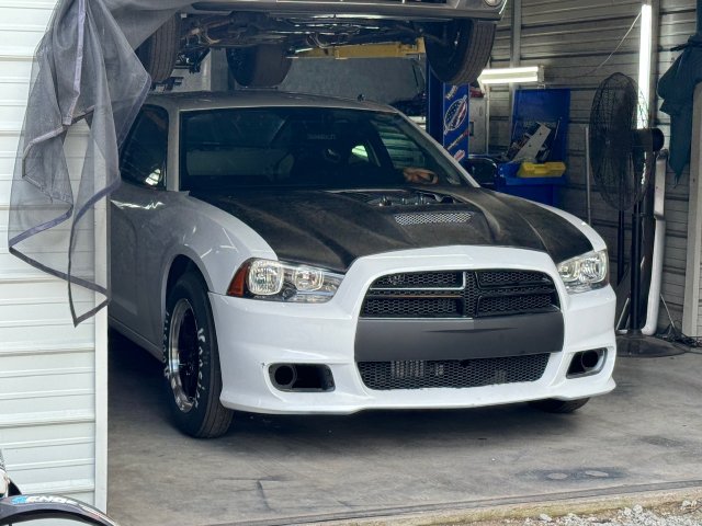

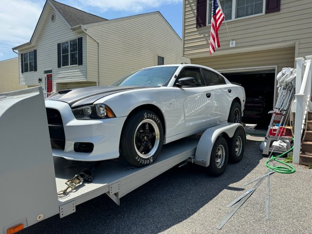

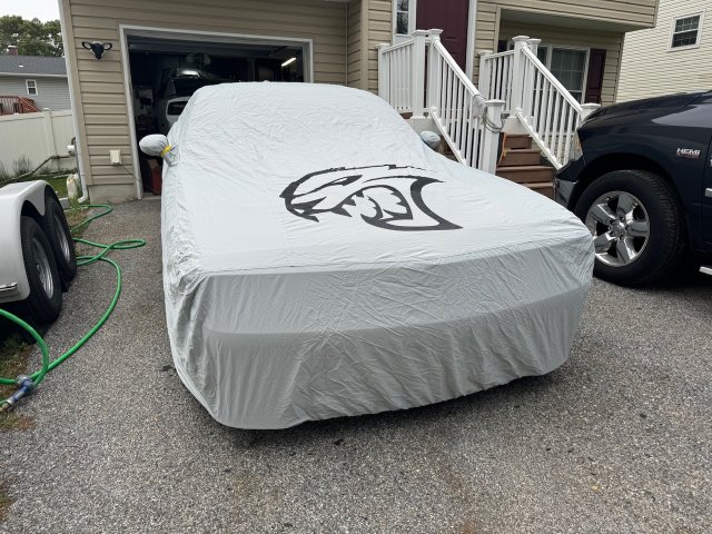

as much as this car burns my soul she got a good cover IMG_2780.jpeg IMG_2779.jpeg
Turn and burn till may 23rd, deconstruction may 24th. Drop off at Jason’s the 25th for cage. Decided to get cage painted white. Black cages lead to third degree burns 😭

Looking good! I need to get a soft indoor cover for mine, insane what car covers cost

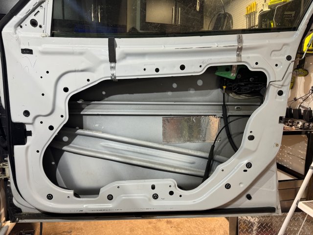

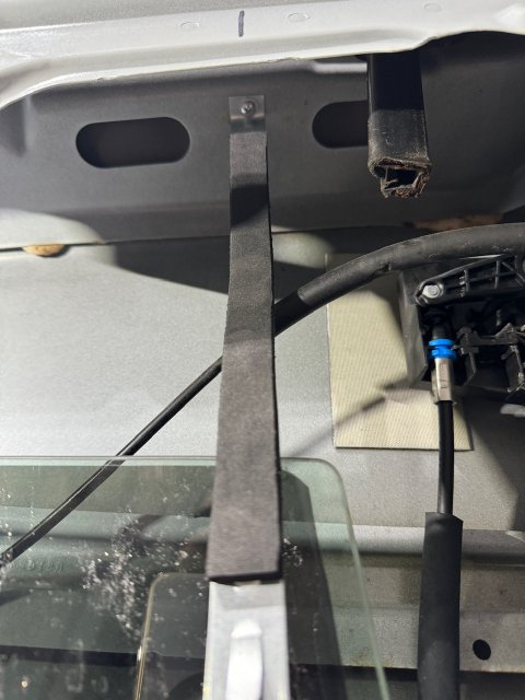

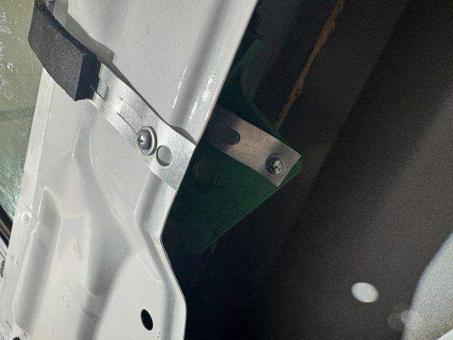

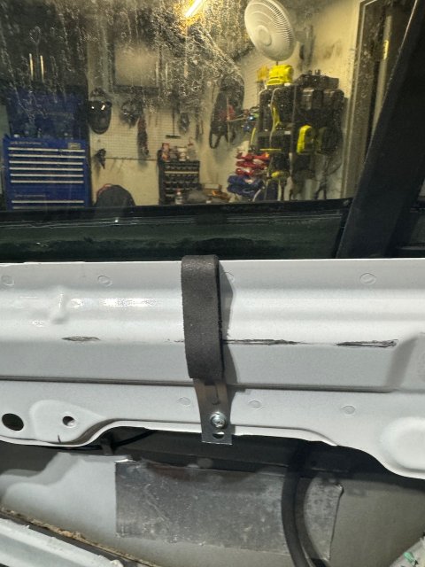

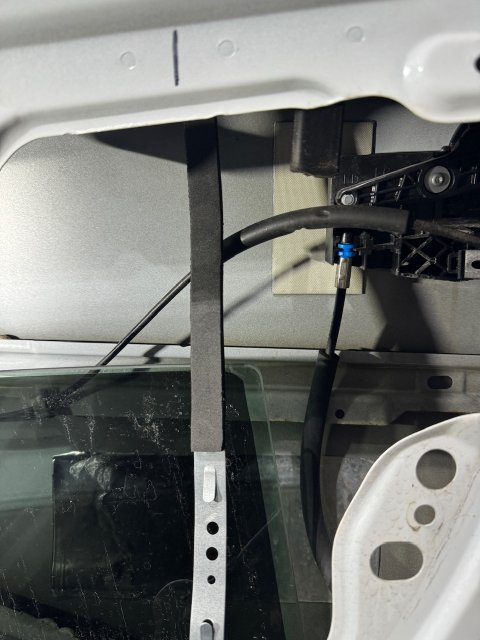

IMG_2823.jpeg IMG_2822.jpeg IMG_2821.jpeg IMG_2820.jpeg IMG_2819.jpeg IMG_2818.jpeg IMG_2817.jpeg

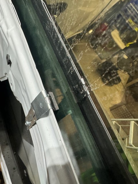

Gutted the doors except the drivers one. Don't need moving windows there. Ordered big sheets of plastic and will be cutting custom door cards. Since this was a police car you couldn’t open the doors from the inside. The hardware simply isn't there. I’m sure there are more elegant solutions but I believe this is strong and safe with the glass thanks to the foam.

Turned out pretty nice

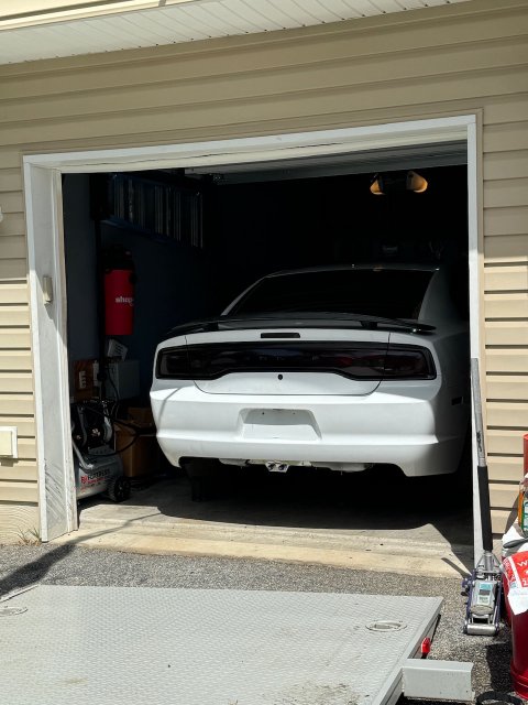

Starting to mount the radiator and lines. Last week I have the car, goes to fab for a cage on Saturday. When I get back we put it on the scales for final weight and then start the process of a first start and idle tuning.

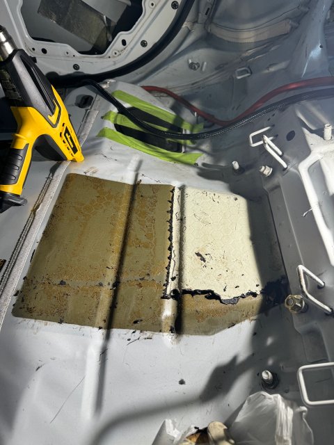

Got home and passed out. Prior to this, cleaned all sound deadening. Shit sucks. Fuck dry ice. Worst method for the price. Heat gun, wooden spoon, goo gone.

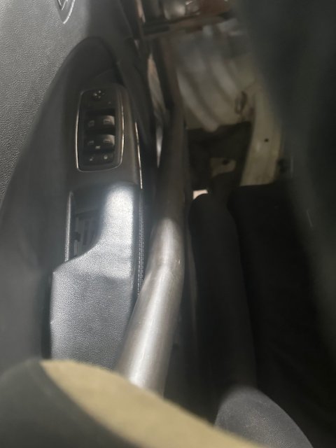

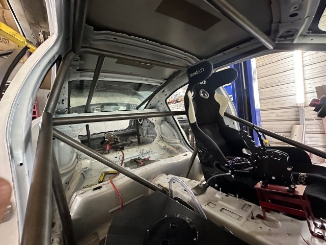

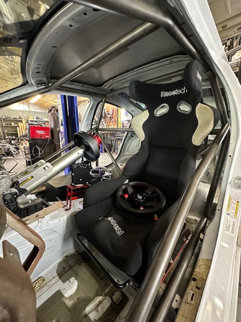

IMG_7635.jpeg IMG_7630.jpeg IMG_7631.jpeg IMG_7632.jpeg IMG_7629.jpeg IMG_7628.jpeg

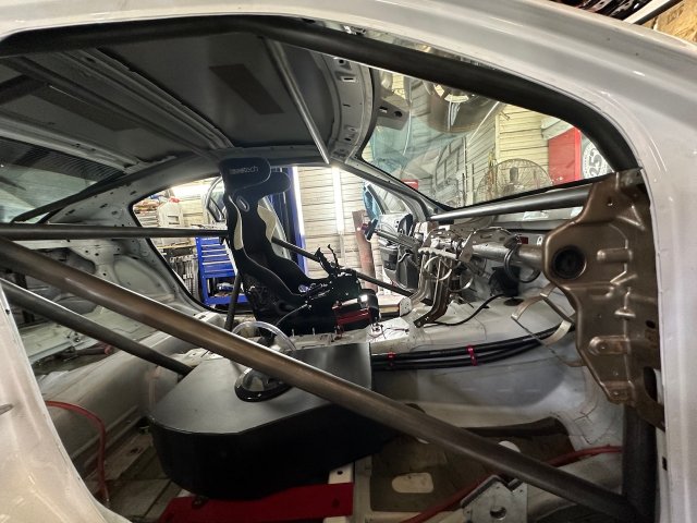

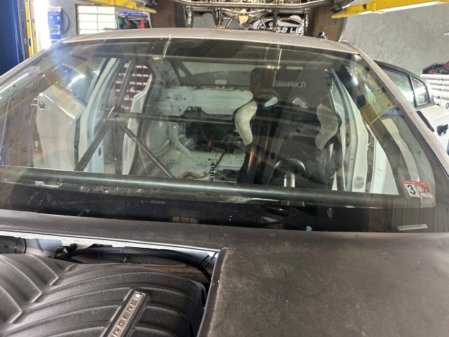

some progress pics. Bars are tacked in for now but its coming along. I really like how he put the bars through the speaker holes. This is going to help stiffen up the chasis a lot. He did it in such a way so far that we already discussed upgrades to make it 7.5 compliant if I ever get there. 😉

Looks good.. Going through speaker holes is how I did my 87 mustang. Gains more room and looks way better then going in front of dash
Same, looks nicer when finished. Keeps it tight.

Looking good! Plenty of room in the back!

Very nice. This thing will be the perfect 8.60 class car. That class is heating up. Only need the 8.50 cage and even the heavy cars like the Mopars can make the power to run right on a 8.60 index. Heads up racing with no sandbagging. 👊
