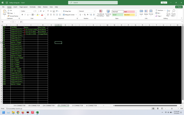

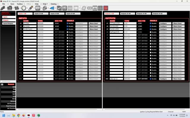

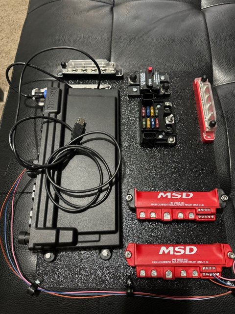

Started the wiring process. Watched a lot of videos on organization of ins/outs. Have a good grasp on it. Didn’t realize it but I bought ALL the connector harnesses… welp time to wire in ALL the sensors… lol. Now to figure out a good place to mount this. I have an idea or two. 😁
