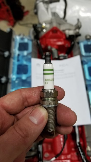

I have never checked my plugs yet, 10,500 miles, maybe I should ?
I wonder at what point is it good to go with colder plugs ?...I'm at 15 > 16 lbs. on the 2.85 & my tuner said when I need to change to go with stock.
I'm thinking setting gap at .028, does that sound ok ?
I don’t think you will go wrong with one step colder. I think that would be a perfect gap for you. We went ngk. But I don’t drive the car a ton I would have been fine with a silver plug instead of iridium. You’ll have to see what you want. Iridium just last longer but silver or copper does better with heat but don’t expect them to last. NGK seems to do good tho with this plug for it being iridium and dealing with the heat issue of iridium

Couple things...normally a burned strap doesn't happen as a result of knock, although knock can be a side effect of a lean condition, which would induce knock. Hopefully that makes sense. The cars I've seen that had knock the strap wasn't burned but crushed into the electrode. Obviously there are exceptions but that's what I've typically seen.
As for plugs and heat range, when I was replacing my engine I checked the plugs in the RE motor and they were Bosch R6 Iridium P/N 9748 heat range 7. NGK 2309 are heat range 7 as well I believe. I left the stock plugs in place since the RE motor is designed for 14.5psi stock.

So you said these are 1 step colder plugs ?
I do like the iridium for longevity.

Same plug as Hellcats.
And the stock plug is double iridium

A base supercharger kit making 6 lbs you would go 1 step colder. Our cars are around 10 then going more on top of that should be going a step colder. Can you run stock heat range with more boost, yes. Just more insurance with more boost to go colder.
I read stock heat range is a 6, that bosch number does show a 7 heat range:unsure:

stock plug heat range is a 6, these are a 7
ok so higher the # the colder the plug
Have not brushed up on my plug knowledge lately

well somewhere I got wrong info. Being stock is a 7 then they should be fine. The NGK also is a 7. My bad
So maybe 8 heat range ?

Don't change heat range just because, do it based on how your current plugs look. Too cold and they get sooty. I ran heat range 7 in the old car as well (2309 NGK) and it was also around 16psi. I'd expect that to be good to close to 1000hp.
I thought stock was a 6 being it is a 7 then stay with. I ran 20 lbs of boost with a 7
I hate spreading bad info and I don't know where I read stock was 6
It happens
It's actually more difficult than it should be to find specs on the stock plugs. I had to do about 3 cross references to eventually figure it out.
