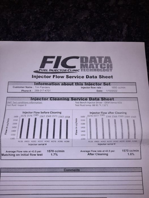

How much to clean them? I have never sent a set out to get cleaned. My friend Tim sent his out running 8's on e85 this year and before and after flow was basically the same

Test and clean, and shipping, @ Havoc Speed - $175.59
