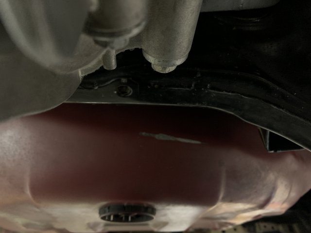

Has anyone inspected their trunk by their subframe? I have definitely had some movement there and have hit the underneath of the trunk
59,393
206,097
with what? What was hitting?

so what do you think hit the trunk? There is a gap
