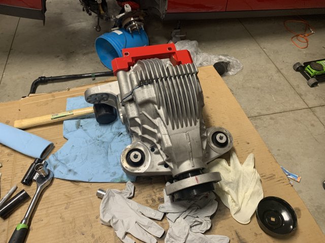

Really no suggestions besides to torque you use a torque wrench and then hold with another ratchet. Another person for the ratchet helps. View attachment 57210

I did 45lbs on the little bolts and 90 on the big bolts.
