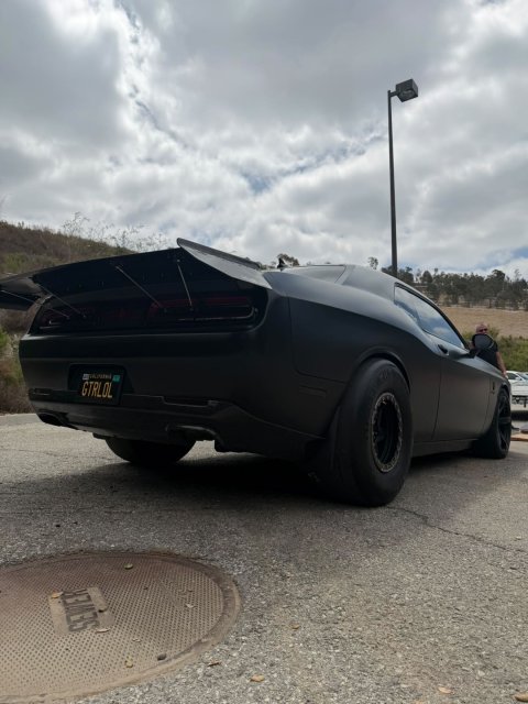

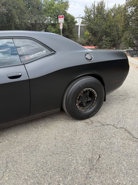

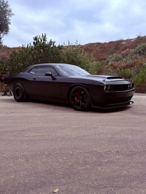

Here is the beast! Whipple 3.8 / 3.0 pulley at 26psi
Car scares the shit out of me lol

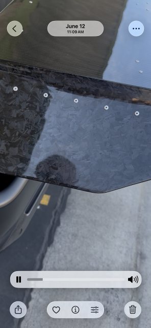

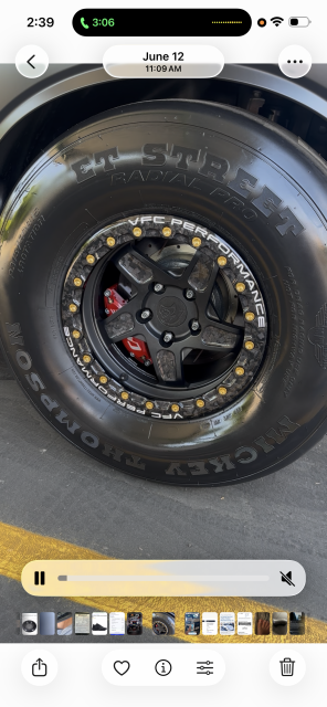

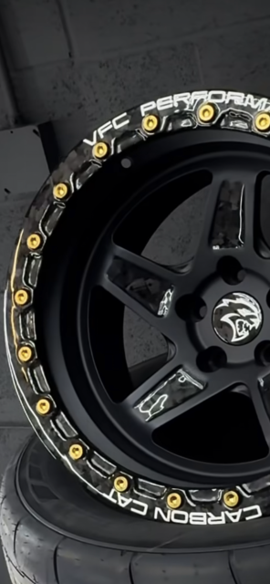

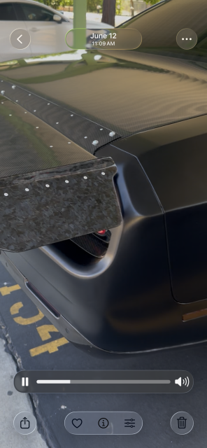

Wing brand and wheel brand and specs with offset?
Jason at Carlin Fabercation for the wing. Located in Southern cali
Destroyed Kustoms did the carbon work on the wing.
also in Southern California.
custom wheels
VFC performance located in AZ
15x 10.5
Do me a favor and and mention my name.
James
PRIMETIME Racing. 👍
