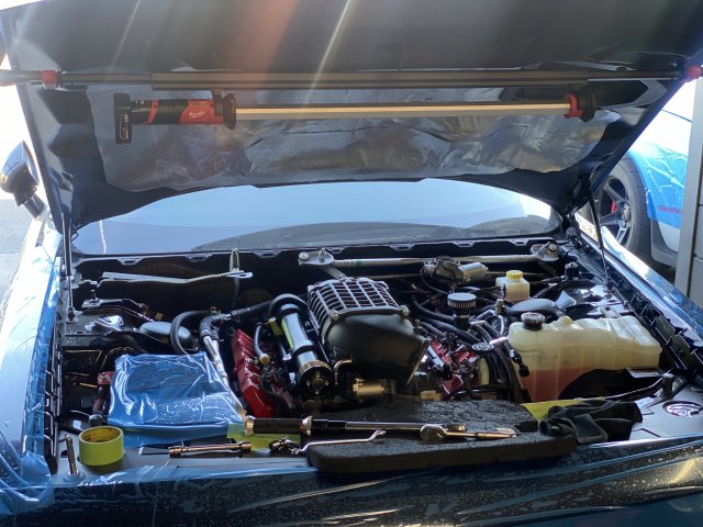

Making some progress this week. Maggie is back on the car. 52510FC1-59E6-41F4-AD6D-797F266D62C2.jpeg
Today or Monday will be the engine flush and fresh oil change.

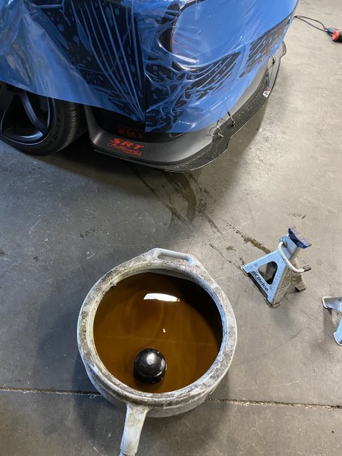

7E6531BC-9D53-4F00-AE79-A34A88F69CC0.jpeg 76C40CCB-2B3E-42F0-9F3C-182C4CE2FDCF.jpeg Shop did 2 oil changes to flush out coolant.

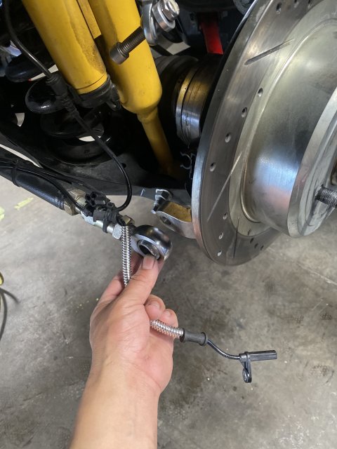

Also finishing up the 15 inch Carlyle conversion.
Need to find some new nuts and bolts for the rear lower control arm. Bolt is to close to the wheel.

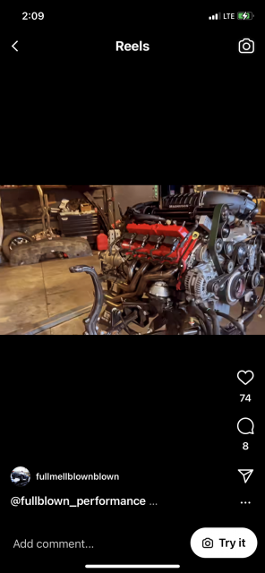

everything is installed and looks good. We never were able to get an actual dyno hp number. Tires were spinning on the dyno so we said enough is enough. Highest rwhp number we saw was 1100. Just waiting on the Mighty Mouse catch can and then picking the car up next week. 65268E36-833D-4624-98F4-F3E6AE49D502.png
