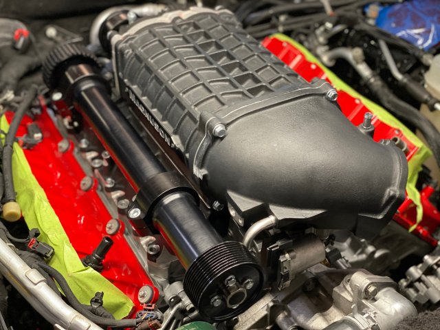

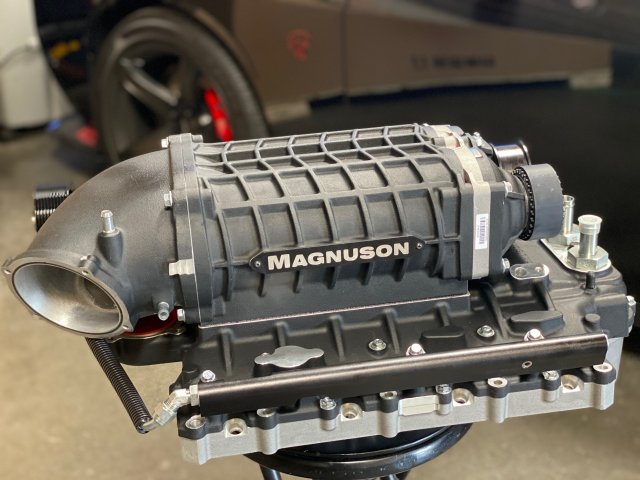

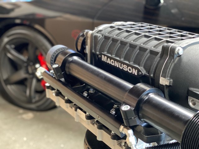

Im thinking there is very few Magnuson SC in the Hellcat community so I thought I would share my build with all of you in here.
Well I found out the hard way is that the stock 2.4L SC is not enough to feed the 426. SRT AutoWorks in Phoenix AZ has done multiple Whipple’s and 1-2 KB’s including Marc’s monster from Hell with the Whipple. So me Tommy & Marc all agreed to say... let’s try something different. So I’m like let’s do it. Quick shout out to Marc! Marc brought to my attention about the Magnuson and it’s upcoming reputation and performance.
So I had the Magnuson sent to Jokerz Performance for their full tilt race port package & it just arrived at Tommy’s shop yesterday. Car put down 954rwhp & 938tq in a 110 degrees heat on a stock blower.
Now with the Magnuson I thinking around 1100rwhp.
Had to upgrade to 1700cc injectors and a Fore triple pump system.🙄lol

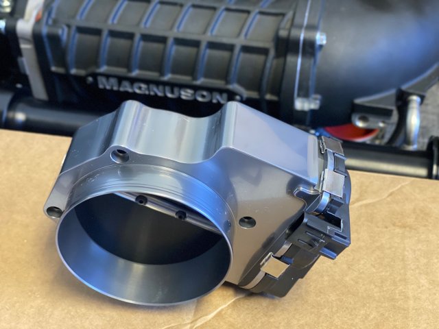

That’s the VMP 105m TB. D934A870-E85F-4F6B-96AA-CFCFB3988564.jpeg 2E1260C0-BA42-44C2-9E19-256E695C648E.jpeg CC371A34-537F-4F65-83C6-8E3C89B1FBCD.jpeg 713A2A10-3293-4DA6-B59F-C6A2A3F7E003.jpeg
IMG_2036.MP4 D934A870-E85F-4F6B-96AA-CFCFB3988564.jpeg CC371A34-537F-4F65-83C6-8E3C89B1FBCD.jpeg 713A2A10-3293-4DA6-B59F-C6A2A3F7E003.jpeg 2E1260C0-BA42-44C2-9E19-256E695C648E.jpeg

NIce! I am sticking with the stock super charger. FAS is porting my snout and I am getting the vmp 105 mm throttle body a little later down the road. I put down 956 with 1010 torque with the stock blower on the same dyno as you. But it was in the 80s. Not 110. You will have a monster!

Thanks alleycat. Just waiting on the triple pump fuel system to come in and away Tommy and Theo go.
Waiting to hear back from Magnuson right now. Might have to order a different cog pulley combo.
States on their web site if your pushing 1000hp plus you will need 27% over drive cog pulley . So I’m just doing my research.
Lol it never ends......
I will post up in here as the build goes on.

ok Just got off the phone with Magnuson and recommended the 3.49 SC pulley it comes with and for my set up and mods they recommended the 27% over drive cog pulley set up to start out with and go from there. Ordered it and it’s on its way!🙄lol

With nothing else to do (all my much needed track time has been cancelled) I am dying to see this thing get going. I saw it while at the shop last week and it is a beautiful piece. Tommy said it will be on next week and tuning will start. The unknown at this point is the drivability tuning and whether it is going to be easy or a challenge. This is the first for them so fingers are crossed. I suspect that we’ll see some big numbers on the dyno. At least 1100 for sure. I can’t wait!

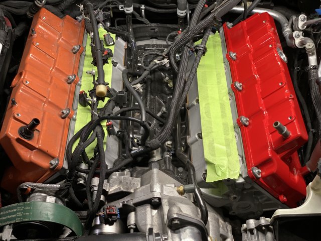

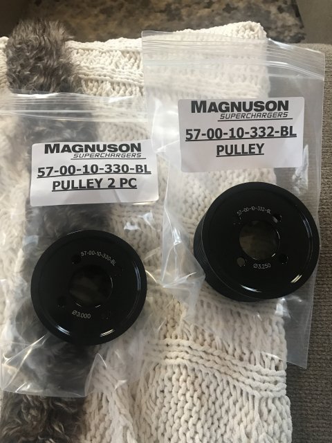

Here is a small update for everyone. Just received these 2 pulley’s from Magnuson yesterday. 3.0 and the 3.25. I ordered them just Incase shit gets really bad in California.

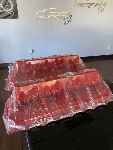

Just waiting on the valve covers to be done. Had them coated red. I can’t stand that hemi Orange lol.
It’s been awhile but all parts are in and ready to go.
Like Marc said Magnuson will be on next week and the triple pump system as well. Lol Marc i day dream about it every day.

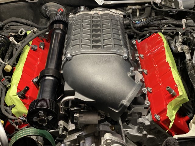

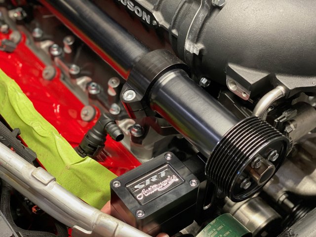

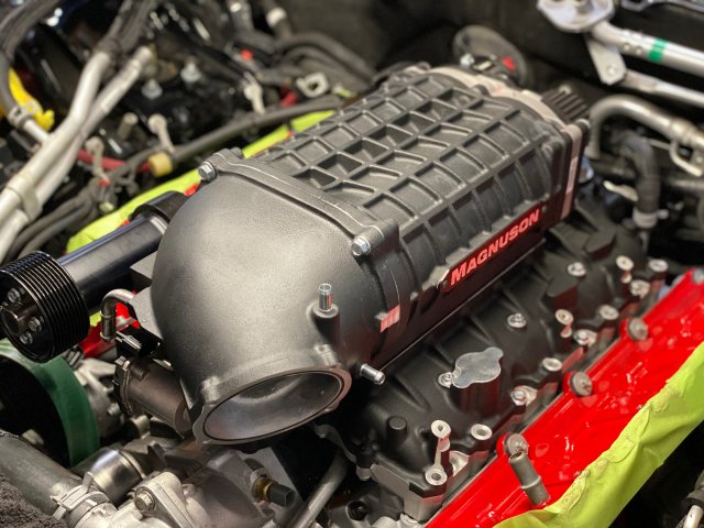

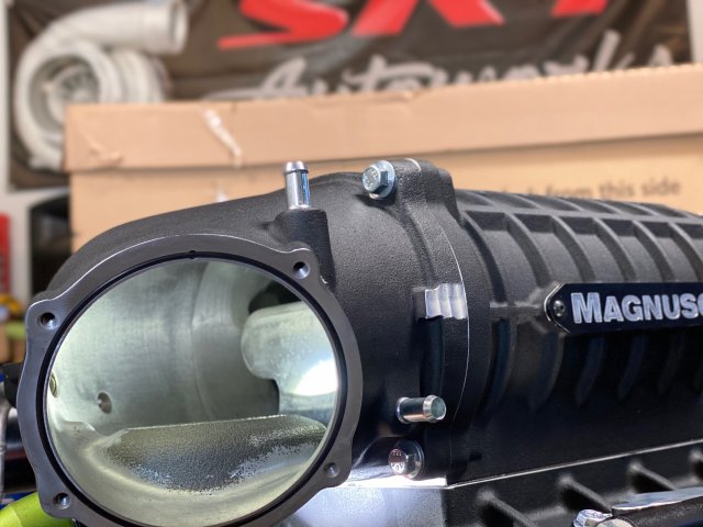

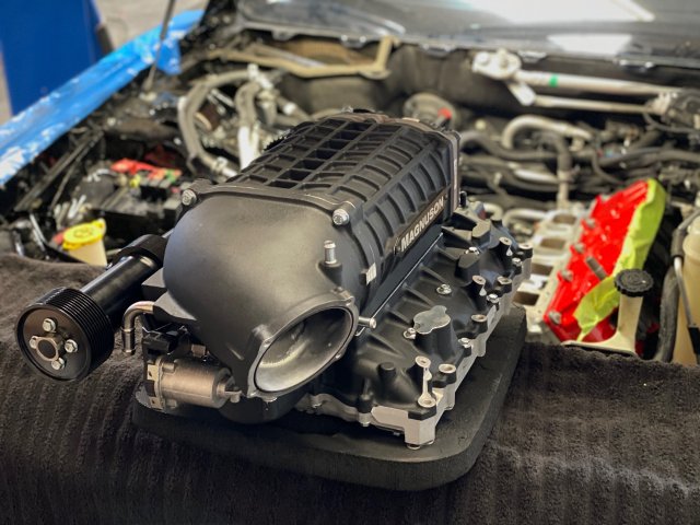

B2EE6A94-068A-4C5B-A659-16E872727A8E.jpeg B42DC2CC-774B-4F37-BFDB-415F967A553F.jpeg
Valve covers are in. Had them coated red. I can’t stand that hemi orange. Super charger should be on by the end of the week. Tommy and Theo are installing the Fore triple pump system today and tomorrow.
