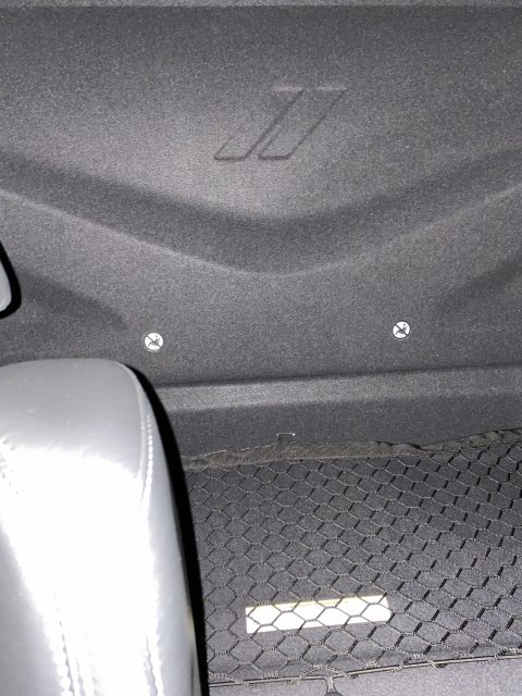

I ordered a Rear Seat Delete Kit today...finally, it’s here!!!😁
5,198
9,660
View attachment 27717 View attachment 27716
Finally all done! 6”1 and about 220lbs I’d say screw the install lol. Overall looks good. Quality of the kit I give it a 7.5.
Anyone else that does the install them selves be carful of scratching the panels when you pop them off to remove seat belts.
StinkEye gave me a heads up to remove the passenger seat. That made it much easier to install the kit.
Looks good, thought that was a given, to remove the passenger seat :LOL:.
So you got that stubborn bolt you was having trouble with, that's the hardest part of the install really, getting the seat belts out.

Yes that was the hardest part,was the T50 star bolts. All 4 were a pain in the ass to get out.
