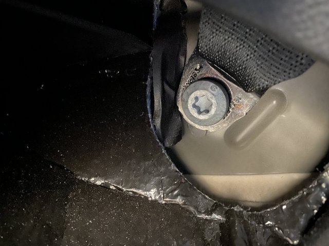

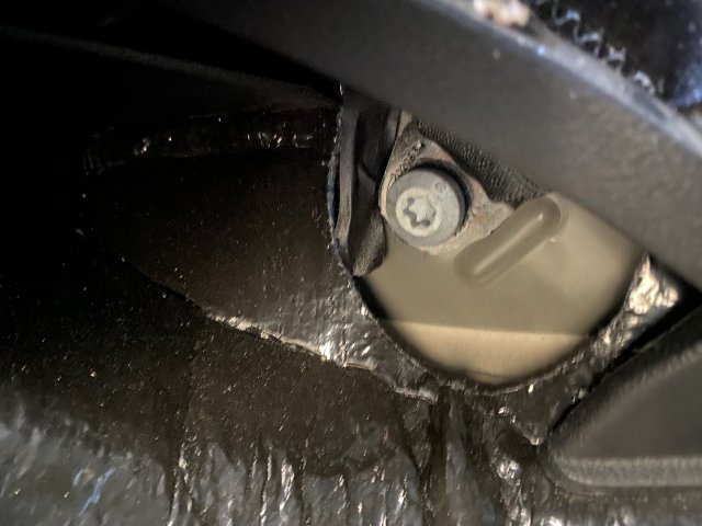

Anyone else having a rough time getting the T50 star bolt out on the bottom of the seat belts.
I’ve tried everything and they won’t come out.
I watched speedy’s video on it as well.
Any tips on how to get them loose?

I was able to break mine loose with just a 3/8 breaker bar. Once I got a few turns on it my 3/8 DeWalt impact spun it out no problem. A few of them were tough.

Just slip a pipe over your ratchet. Floor Jack handle, whatever. They will break free.

Them are tight with lock tight on them I had 2 slightly used T50 lisle bits broke them the rest of the way. Harbor freight junk tools in most cases but with a 3/8 breaker bar got them loose then did my rigid impact to finish it up. Good luck!!

Did you guys leave or take off the plastic side panels when you removed the T50 bolt?

They need to come out to remove the rear package tray. Top ones need to come out as well.

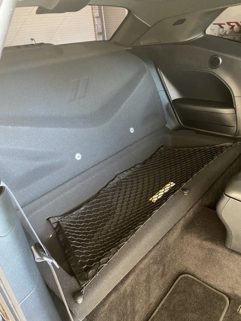

4C5864AC-6582-4E31-98FB-EF842CFF5E9D.jpeg A93C78AF-CCC3-4700-B7AA-928362EE53DF.jpeg
Finally all done! 6”1 and about 220lbs I’d say screw the install lol. Overall looks good. Quality of the kit I give it a 7.5.
Anyone else that does the install them selves be carful of scratching the panels when you pop them off to remove seat belts.
StinkEye gave me a heads up to remove the passenger seat. That made it much easier to install the kit.

Looks great. Nice job.
