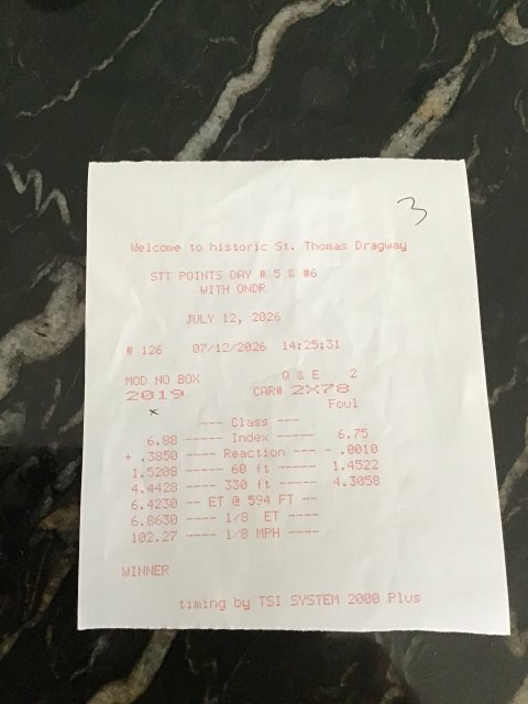

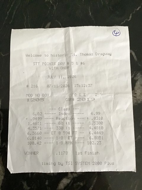

Well it has taken a while but I finally got to the track and made my first runs, 8 to be exact. Between the weather and waiting for some parts it was a later start than I had hoped for, but I finally got some passes in and things went as good or even better than expected.
Nothing broke, the car went nice and straight down the track and it hooked up really well with zero wheel hop issues.
I did spin the tires off the starting line on my 3rd pass but that was a rookie mistake on my part because I had completely forgot to check my tire pressures between rounds until my track neighbour, who was kind enough to answer my rookie questions throughout the weekend, brought it up just before my 4th pass and when I checked they had climbed to about 23 psi. I dropped them down to 18 psi and made my best pass of that day.
We got to the track Friday afternoon because they were doing a test and tune, but typical for this summer it got rained out.
They were only doing 1/8th mile runs this particular weekend so no 1/4 mile times yet but it was a good way of getting my feet wet I guess. It was also bracket racing and I realized I have some learning to do there as well.
This was actually the first time I have ever taken this or any other car down an actual drag strip, so mistakes were made. lol.
My first pass was pretty slow because I launched like I would on the street, expecting it to spin but the car hooked up nicely and went straight. My second pass I red lit by -.0189 and did a 6.99 in the 1/8th mile and used that number for my dial in , my third pass I spun the tires and got put out and my fourth pass, which was a buy back, was actually my best reaction time of the weekend at .0310 a 60’ of 1.538 and a 1/8th time of 6.885 which put me out for going too fast.
Sunday we got one test pass and I red lit trying to hold the brakes and get my launch rpm up a little. I dialed in at 6.88 but broke out again and was put out first round. I did a buy back and won my first round ever when the guy red lit by -.001, I got lucky. lol My next pass I got put out for going too fast again but I was still happy because it was my best 60’ and 1/8 th mile time of the weekend.
Ultimately I know these aren’t the most impressive numbers out there but it was still a lot of fun for me and I am sure they will get better with more experience.
When I first started this thread I had some people shitting on me for not following the advice I was given here and I went ahead and bought the used Gforce cradle and installed it anyways. I will be honest and say I did have some unexpected issues with the stuff as I had to buy new ring and pinion gears and get them installed and I bought a new driveshaft as there was a vibration issue but as I noted way back in the beginning of this thread, there was also a small groove in the driveshaft which honestly had bothered me from the time I noticed it anyways, so now I don’t have to worry about that anymore.
All in all though I still believe I got a good deal on the parts and they seemed to do what they were supposed to, get the car to hook up and eliminate the wheel hop issues. Hopefully it holds up for a while now and I can get some more track time in and work on my reaction times and develop a routine.
Lots of fun and smiles were had by everyone.
Here are some time slips, I am car #2019
Pass 4 day one
Pass 3 on day two and my first Win !
Pass 4 on day two with my best 60’ and 1/8 th mile times.
Some tire wrinkle at the line
Back in the driveway.

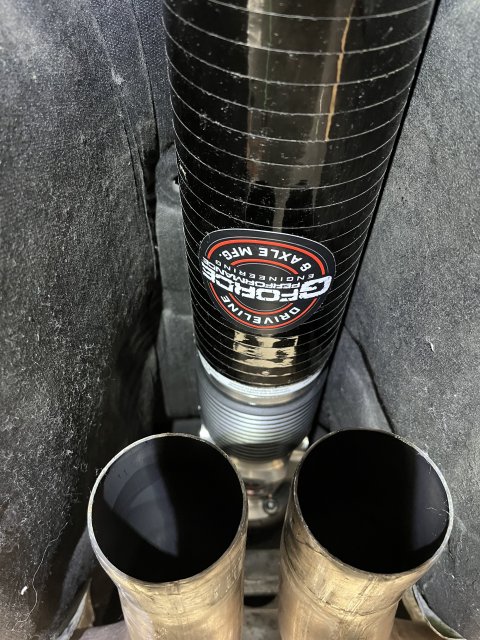

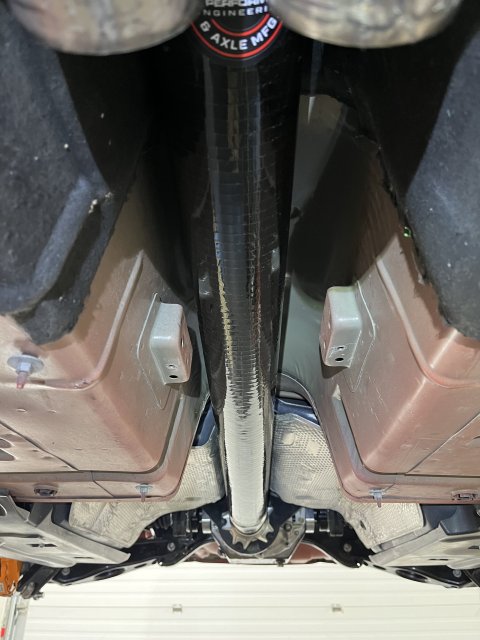

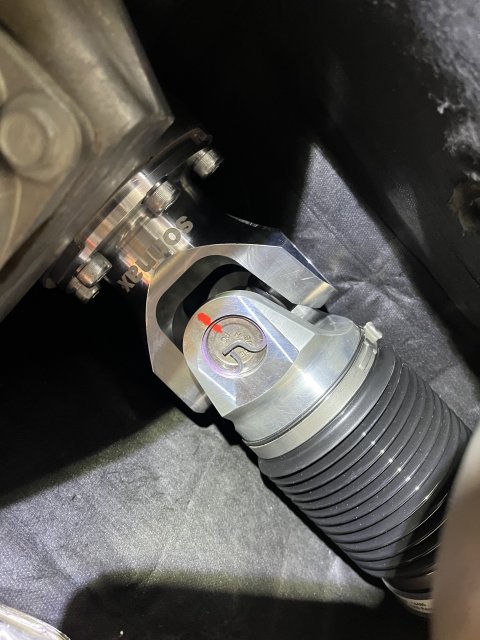

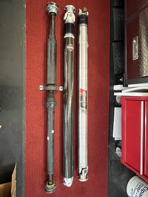

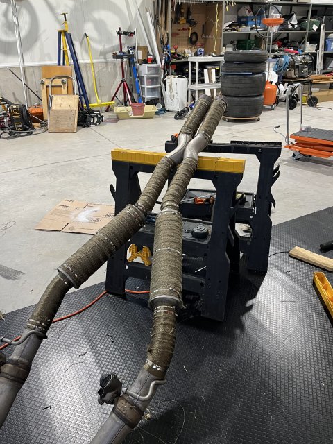

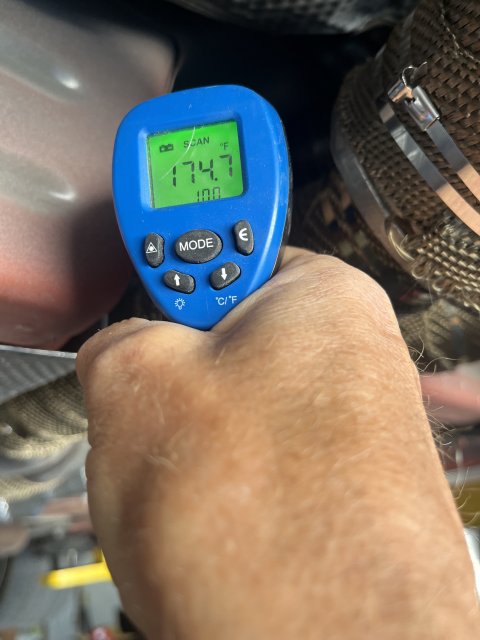

Also, on your driveshaft.... you need to keep the heat from the exhaust off that. CF will cook and fail if you don't.
Thanks again for your input, it’s appreciated.
The heat was definitely a concern of mine and I raised that question with the guys at GForce. I’m not sure how true it is but they said they have been working on that issue for a while and apparently they employ a significant amount of a “press fit” when installing their ends as well as a bonding agent to help alleviate this. They also said they are currently developing their next generation of driveshaft. Could be bullshit I don’t know ?
I actually bought another factory heat shield, like the one already on the car, and with some minor modifications it fit in front of the factory shield and covered the driveshaft right up to the transmission. As well I bought a roll of DEI titanium exhaust wrap and did the exhaust. Not sure what else I could do to control the heat ?
I don’t drive the car a whole lot on the street and I live in the country so stop and go traffic isn’t an issue. It’s usually 1/2 hour drive into town with the wife for dinner or groceries and cruise the beach.
I put the car up on the hoist and checked the temperature of the driveshaft and area with a laser thermometer probably 10 different times after various drives and never got a reading even close to the 300 F that is apparently the danger zone. I guess only time will tell.
I called several different driveshaft shops before I pulled the trigger and there was a general consensus that they have all had problems with these cars.
A few of the shops said they don’t even make driveshaft’s for these cars anymore as they have had so many issues. Mark Williams is one of those shops I called as I was even considering dropping the extra $$ for their 2 piece design but they don’t make them anymore.
The GForce guy said “ you don’t want to be in the driveshaft business “ lots of problems.
So hopefully it doesn’t fail but at least if it does it won’t tear my car apart.

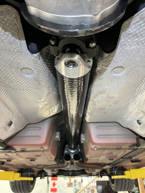

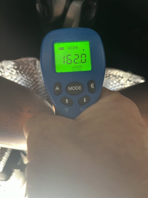

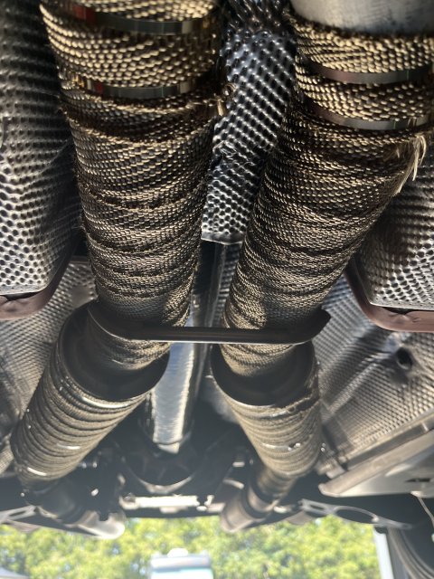

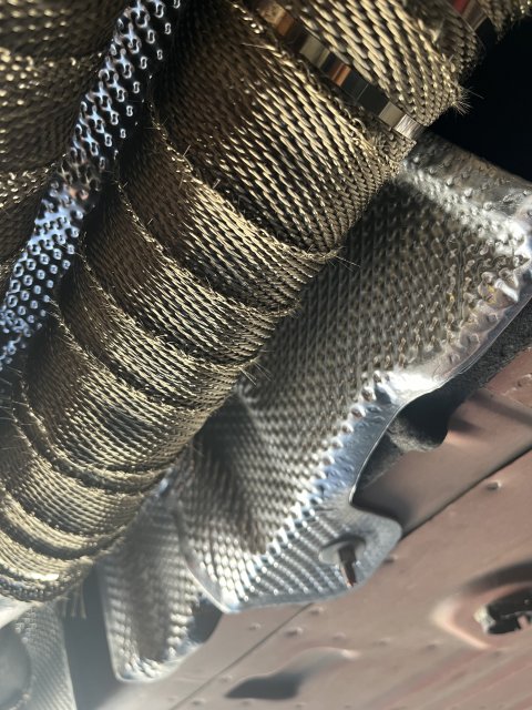

Here are a few pictures I took today of the attempt I have made to protect the driveshaft from excessive heat. The first picture shows the factory heat shield which I realized could be easily modified to protect the front of the driveshaft, so I just got one online and installed it and wrapped the exhaust. We went into town today and did some errands, we drove around a bit, cruised the beach, let her rip a few times around town at the request of various bystanders and put a few smiles on everyone’s face but my wife’s. Filled up with 93 octane then wound it out a couple times on the backroads driving home, got yelled at again, and put it on the hoist immediately to check some temperatures.
Total drive was maybe 45 km and 1 1/2 hrs of time. Pretty typical of how the car gets used, have some fun, get a couple hits of adrenaline and put it away happy that I made it home without a ticket.
The car actually had 91 octane in it when I went to the track, not sure how much that would have slowed me down ?
Anyways here are some pictures of the heat shields, the wrapped exhaust and the temperatures, which were typical of every other time I had checked.

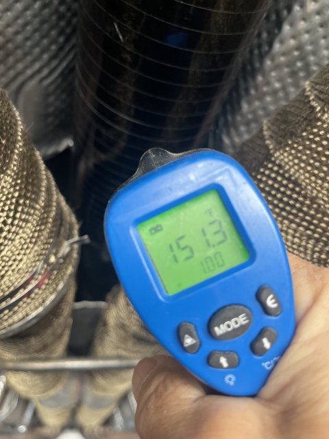

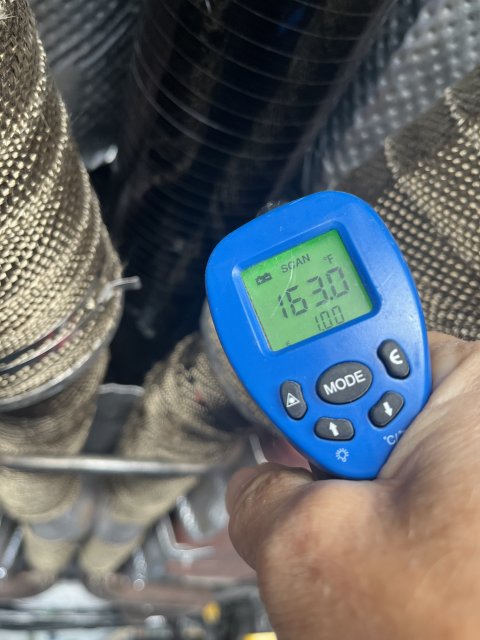

View attachment 184824 View attachment 184825 View attachment 184826 View attachment 184827 View attachment 184828 View attachment 184829 View attachment 184830 View attachment 184831 View attachment 184832 View attachment 184833
Looks like a mummy..:giggle::giggle::giggle:;)

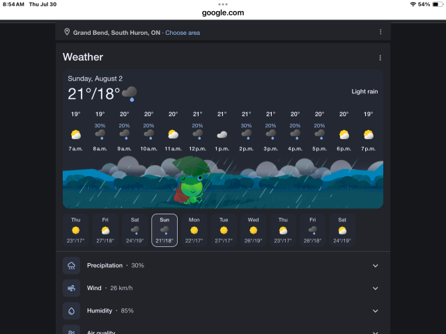

Here we go again !
Biggest event of the season for this track(Grand Bend Motorplex) which is only 1/2 hr drive from my home and Mother Nature is up to her old tricks. This has been a reoccurring theme this year.
Oh well the tickets have been bought and the motorhome,trailer and car have been loaded, gates open at 5:00 pm today, hopefully I can squeeze in a few runs before the weather puts a damper on things. It is a long weekend here and Monday is a holiday, so there is a chance they make runs Monday if the rain shuts things down.

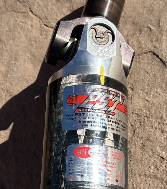

I can tell you some big research was done by QA1 on a fiberglass driveshaft on a Hellcat, here in MN.
They used my 2015 Hellcat for the prototype. We tested temps ON the SHAFT (stick-on temp probes) itself after 20 minutes of on and off WOT (road course) and after several passes on a drag strip. You guys will never get a drag car as hot as using it on a road course. They never believed the temps from the exhaust were consequential FYI. That vehicle still runs the 2.5” diameter jewel. A few others had problems initially with their connections and therefore unfortunately the volume was not great enough and they did not build many. But as tested, the exhaust system does not radiate enough heat to the drive shaft to cause concern in the opinion of a few automotive engineers.
1,613
4,022
It's too bad QA1 gave up on the HC shafts. Been very happy with mine - still A-ok after 8+ years. Granted, I do not road race the car, but honestly never was too concerned about over-temping it - air is a relatively poor conductor of heat, and there is plenty of air gap even though things are a bit tight under there, but air is still moving and flowing to some degree with the shaft spinning and vehicle motion.

We beat the hell on it using the short and even the long course. I do not remember the temps he got, but the road course stuff was a bit more hot than the 1/4 mile passes. Your golden just on the road.

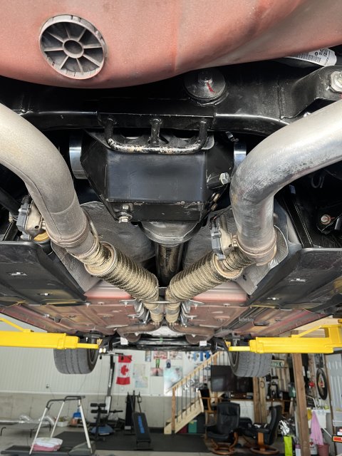

Super happy with my QA1 CF driveshaft. I built a custom heatshield to protect from the end of the tailshaft to the factory heat shield so the front of the drive shaft is fully protected from the exhaust heat. In the rear, the exhaust splits to go around the diff and seems to have enough distance I don't think it would be an issue.
8,877
7,788
Is that a bar welded to the rear cradle for jacking up the car from??
