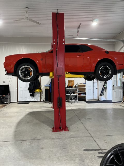

Well the car is “done”, other than an alignment, so it is just a matter of waiting for the good weather to hopefully show up in a couple of months.
In the meantime I decided to go ahead with a mezzanine project I have wanted to do since we moved here about 2 1/2 years ago. We live in a barndominium style home that was built in 2020 and although it was framed in during construction, there wasn’t an entrance to the shop from the second floor, which is our main living area, so I decided to go ahead and finish it.
So although this isn’t a post about the car it is the car’s place.
View attachment 177893 View attachment 177894 View attachment 177895 View attachment 177896 View attachment 177897 View attachment 177898 View attachment 177900

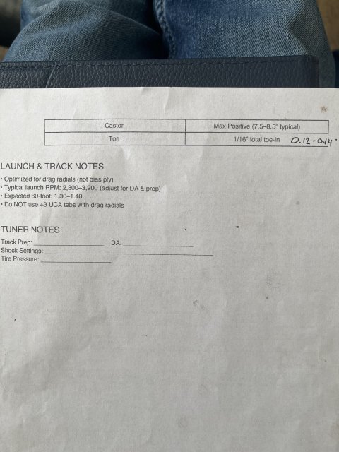

If someone could provide a link or direct me to a post with alignment specs I would appreciate it.
Thanks
3,633
11,722
Factory specs in the front. Positive camber in the rear. I ended up with +2 degrees. Ran 1.25 sixty with that on a 315/60R15 Radial Pro. Key to straight line stability is zero toe in the rear. Make sure that if there's any error, it's to the inside.

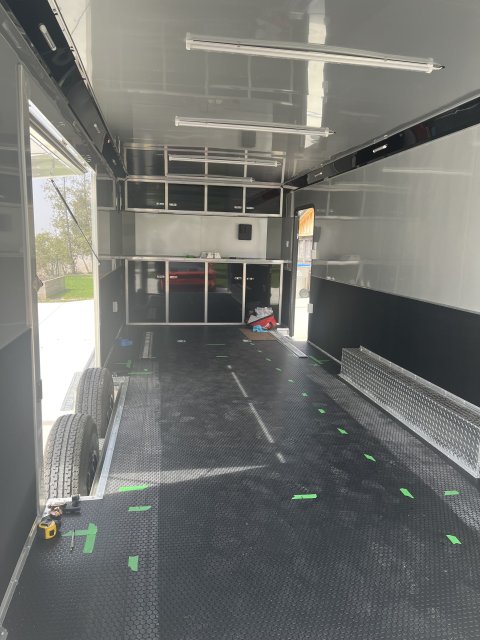

It looks like the weather is finally on our side. Just figuring out where to install the etrack and the car goes in Wednesday for an alignment. Weather permitting I have been invited to a private track day May 9th !! IMG_7932.jpeg IMG_7928.jpeg

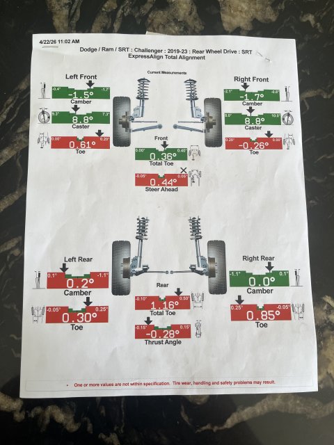

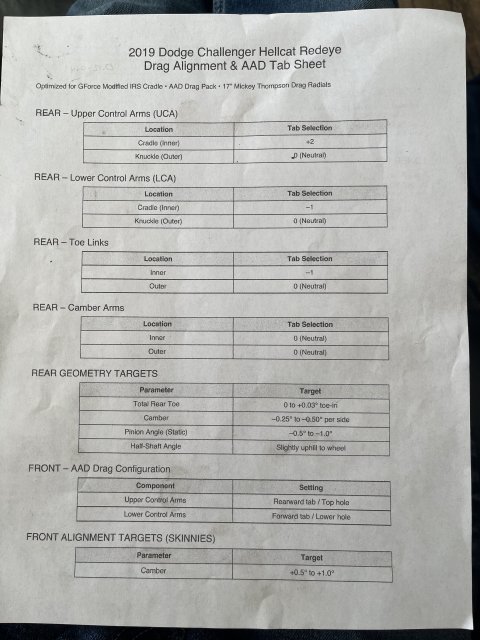

So I actually found specs that are supposed to be “optimal “ for my Gforce modified cradle set up and I had my car aligned today. Everything seemed to work out fine other than a possible u-joint that is failing and the likely suspect for the noise I was hearing. So for what they cost I am just going to replace the u-joints and hopefully that issue will be solved, but you never know. IMG_7940.jpeg IMG_7941.jpeg IMG_7936.jpeg IMG_7937.jpeg

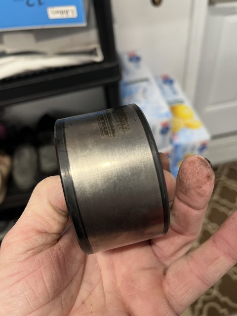

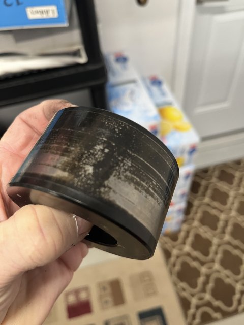

So I decided to replace the tensioner and idler pulley with the Metco product as I did notice that although the bearings seemed ok it was visibly obvious that the belt had been slipping on the pulley as seen by the pictures below

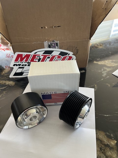

The Metco pulleys not only looked a lot nicer they were considerably lighter. IMG_7974.jpeg
