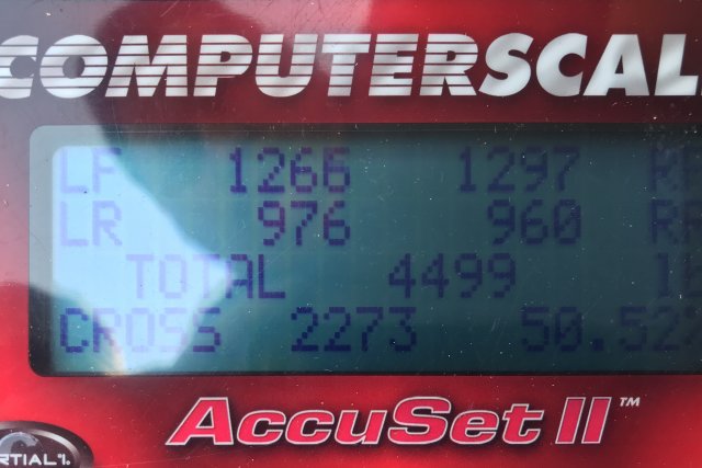

Their maximum load at 50 psi is 1140. Multiply that by four and add a 200 pound man are they suitable for a fully weighted hellcat at the strip. I am talking about the 28 inch ones for an 18 inch wheel. Radials. They do make a street version at 25 pounds a piece.

Sounds like you're not leaving much of a safety margine. 1140x2=2280lbs. Let assume your car, with you in it, has a front weight of 2280lbs or slightly less. I can't answer this for sure cause I have not put mine on my scales yet. Are you still good? Your car sitting with you in is not 50/50 front to rear distribution. How much weight shifts to the front tires when braking at the track? Willing to bet you will exceed the weight rating of those front tires. But what could go wrong with under rated tires at over 140mph?
Believe me, I thought about this because you are right, the street radials are a very heavy tire compared to the race ones I use on my other two race cars. However, they are rated at 1650lbs each. I just didn't feel the weight savings was worth the risk. Remember, there is another racer in the other lane. Sorry for the soapbox. Good luck and be safe!

I have the Hoosiers now. But at only 12 pounds a piece and bias ply they wander at over 140 mph. That is why I was inquiring about the radial MTs. But their weight handling does not seem to suit our heavy car. So I totally agree with you. I have a feeling the street variety will only slow the car down a few hundredths. Because of the radial construction it will have less rolling resistance than the much lighter Hoosier. And I bet it will feel a lot more stable and safer for the driver and as you stated the guy/gal next to you. So I believe you are right on and have valid points/concerns.

You can’t take the total weight of the car and divide by 4. Mine back when I was at full weight…. 892A98A1-9C76-4004-8C58-A5414BDB86E6.jpeg

You can’t take the total weight of the car and divide by 4. Mine back when I was at full weight…. View attachment 115795
So you are making the point to stay away from the ones that state 1297 or below. I am not sure if you were sitting in the car with these values. At any rate I do not feel comfortable with the Hoosiers. I think I will go with the heavier street radial version. I do not think it will slow the car down that much.

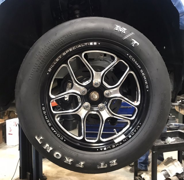

On the subject of front runners…. The M/T Sportsman is the best for a heavy car on the street. Potholes be damned. M/T has a newer ET-R front that is rated for street use and the older ET Front that are not. These drag only tires don’t have a weight rating. They are very common on very fast (200mph) cars and I’ve never heard of their being a doubt about their safety. 5EA13916-84E4-47ED-B60F-79F9F80967B2.jpeg

Are the newer ones on their website? Definitely want to get rid of the bias Hoosiers.
Yes I was in the car. The max weight ratings the DOT puts on there have a wide safety margin (liability) built in and are rated for that on the street where they have to deal with potholes and bumps without damaging the tire. I’m not suggesting anybody should discount the government’s concerns for our safety, but…. 🙄

I think the newer front runners are not made in an 18 inch variety. Marc, you probably have a smaller braking system up front and are using a 15 or 17 inch wheel up front?

Yea. They know that the modern muscle cars are heavy and that LT rating brings weight. If you are still on the street then the weight is worth it. These things match the ET-R rears and they say that they are designed to go with those. I have no experience with them so can’t say how they might perform on the street. The Sportsman's are great.
