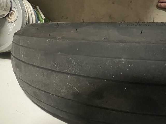

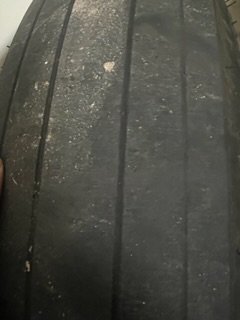

I think this tells me something. One of the front runners is looking normal. This one in the picture does not seem right. I did not pay attention as to which one belonged to which side. I should of. IMG_0865.jpeg

Since it is not over the entire tire I have a feeling it is a bad tire. Something broken internally in the tire. But when I get the new axles I will have them aligned. Do the right and left toe and camber need to be exactly the same on the front?
3,630
11,711
A couple things I think….. Past the finish line on the brakes is when the front is going to come down. At that point, the weight on the tire is going to increase to max and your camber is going to roll onto the inside of the tire. So… you are going to want to put enough positive camber in your alignment to put the tire at zero on hard braking. If not, you’re going to end up putting all that braking on the inside edge of the tire. Not good from a braking standpoint or for your tire. You could wear them down to dangerous without even knowing it unless you check for that frequently. You have the AAD front uppers so you can address that. As far as toe goes….. out is unstable. If you’re wandering around, that could be the problem. Toe in just enough to make it stable in a straight line without wearing the outside edge of the tire significantly.
