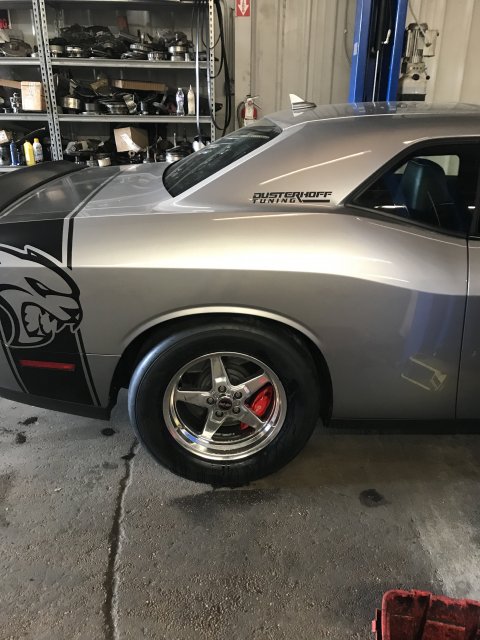

64017402-91B8-4E17-970D-65A75B4D5AEF.jpeg 64017402-91B8-4E17-970D-65A75B4D5AEF.jpeg If you guys want to go faster add this sticker

#70
I wish I had just went straight to e85 in the first place ,better fuel and so much more power ,,you guys need to hit CURT@DUSTEROFF TUNING up on the e85 packages ,here a snippet of the results you can expect ,one of my runs at beech bend this weekend
