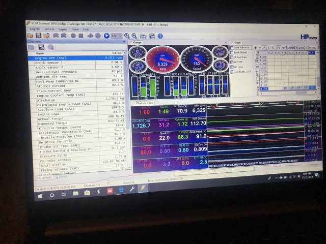

3,309
5,754
#54
Here’s a screenshot of my alcohol percentage on Friday on my way to the track in holly Springs ms , it was spirited driving lol you can see the it’s at 82.5 7880F968-9567-4411-BEE4-79C6CED9B64D.jpeg

Here’s a screenshot of my alcohol percentage on Friday on my way to the track in holly Springs ms , it was spirited driving lol you can see the it’s at 82.5 View attachment 6394

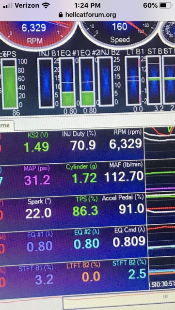

Spirited....pedal 91%, engine load 84%. Very spirited. LOL. Good exposure of info on livetime laptop (y)
