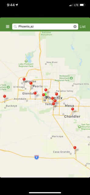

Download the app: Alt Fuel (Alternative Fueling Station Locator)
#1305
56
61
Gilbert
I've heard there's one on val vista and Broadway that doesn't show up on the map that's in the higher percentile ethanol
I haven't verified though
The one in gilbert on higley and pecos is 2 minutes from me. I haven't checked the ethanol percentile but paladin06 has said it's right around 54%
