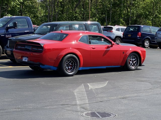

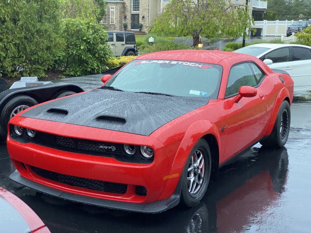

Thanks Ron, I ordered the wide body specific Win Lights yesterday.
Win Lites on SS

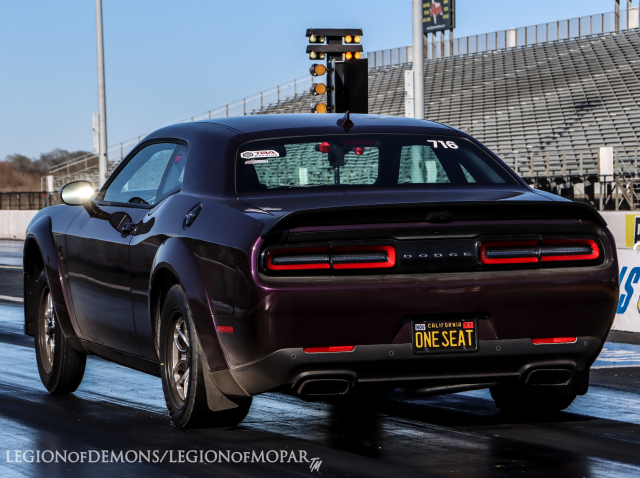

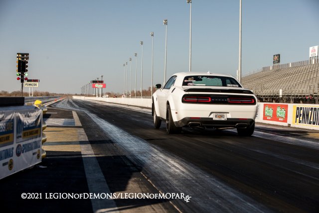

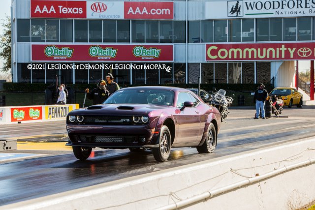

I just got access to some pics from January. Legion of Demons Race. That last photo is of me going rounds in Tim's car. Tell me what you see? @LEGIONOFDEMONS2021_00054.jpg ONE SEAT CROP.png @LEGIONOFDEMONS2021_00219.jpg

Looks like you cut a decent light and are rolling. Close dial ins.

There is way more to see there if you know what to look at. There is only .03 difference in our Dial ins. It was staggered .500 pro tree. My 3 Amber Lights are already off and I have rolled completely out of the beams. I am not 100% sure but I am thinking his Green light is on (as well as mine). I cannot see how my Ambers could illuminate and go off in .03 second. So My assumption is that both mine and his Ambers have come on and gone out and I have rolled out of both my beams, and both his are still on. Easy win.

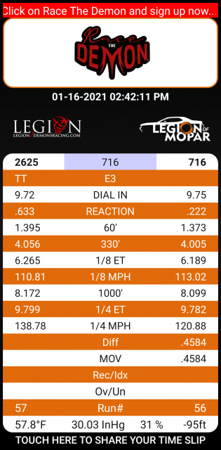

What does the time slip reveal?

I never saved any of the slips. But you made me go in tha app and it is still there. I am pretty sure this is it. The position of the cars and the dial in's and my (Tim's) car number match. Well, They are using MY car number while I was racing his car. I was told it was something to do with the Ladies in the Tower getting all confused and therefore riled up! LOL
2,199
3,774
Dialed a 9.72 and never got there.
Not even close.
Forget the R/T, that there is a duck. 7 tenths package whew.

Both asleep at the light

Unless you run a PT all the time, it's tuff to cut a light.
