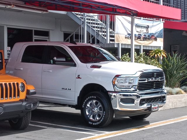

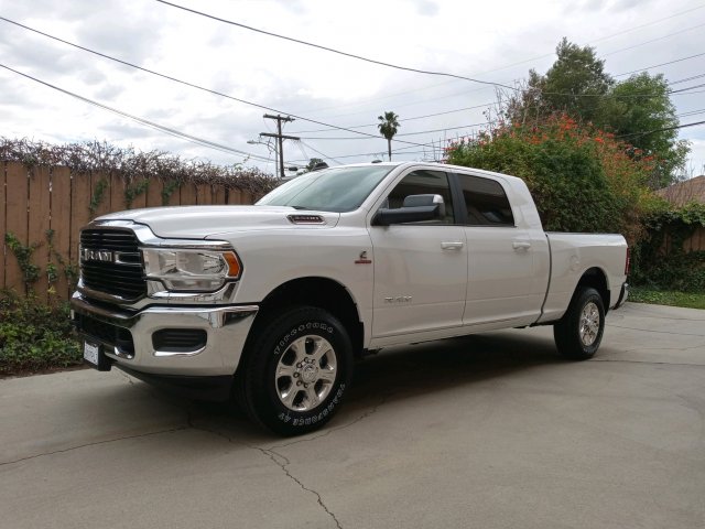

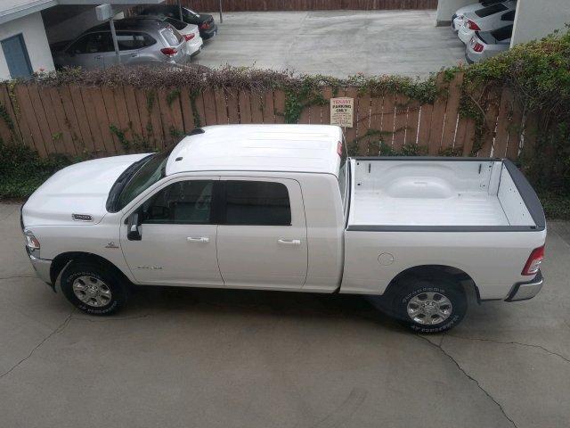

OK, so I forced myself to wait till April to check on my Truck. Then I called over there and the truck was there. 8 Weeks and one Day. Not even sure when it actually arrived. Don't care. While I was there I checked on the Super Stock. Yes the Drive Shaft was delivered as planned and my Car was on the rack, all the new Parts still in Boxes laying on the Ground. Busted Diff, Axles and Driveshaft on the ground. Yes it broke that ear off as is typical. An hour or two after getting home with the Truck the Super Stock was ready to go! What are the odds............ I will get it in the morning after they wash it. I have TOO MUCH playing around to do with this Truck to do right now.

A - nice truck
B - congrats on the SS being back in one piece
Good luck with them both. (y)

nice looking truck Ron! Should pull that SS no problem!

Nice RIG!!! Good to hear the Challenger is coming home soon too! Are you going to race it again soon, break it in, add a diff brace?

Looks like you have lots of room to sleep in that thing!

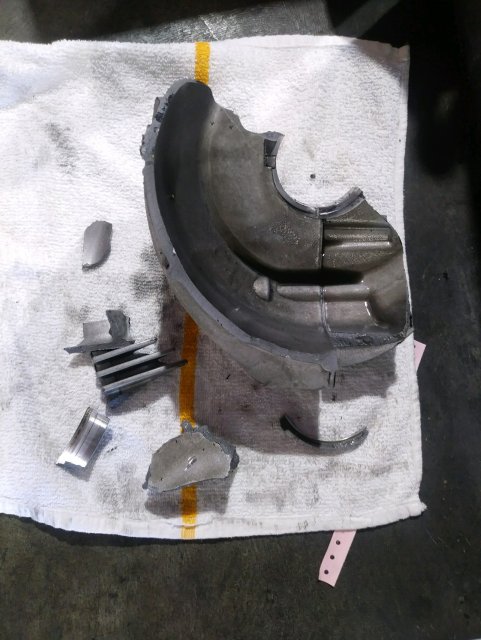

I know you hurt some diff's with the Demon. Did you tear the ears off any of them like with your SS?
One ruined the bias and started one legging and another busted on the hit also on 808 mode (VS the SS on 807). The one on the Demon that busted seemed to do it more from spreading the case apart. The SS absolutely broke the ears off and never leaked one drop of oil.

I always attributed those case explosions to the Demon case heat treat. It seems to me that they clearly passed the point where harder = stronger and clearly got into the too hard = brittle point.
IMO, the ears breaking off is just poor engineering. Thus the reason the P4D makes sense..
This all reminds me that the diff in my '19 is an actual Demon unit and has a lot of runs on it by now. I may need to do something about that before I run it anymore.
