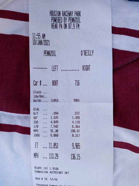

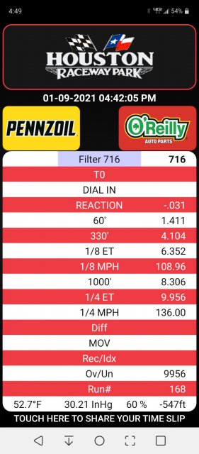

I’m dying over here. Let’s see those times!
Sorry, it has been a long day. The car started out having the Hiccup Blues. So, no Joy with the times in the 10. Oh's......10.09, 10.08, 10.07 and 10.09, but a couple were at 137 mph. So the MPH was a personal best by far, but the ET's were disappointing. So, I went for it and used the HPTuners program to reset the PCM Adaptives. Interestingly I did not have the option to reset the TCM Adaptives which I wanted to do. I will have to email them on Monday and see if they can add it.
After I reset the Adaptives the car took one pass to learn and that was a 10.07 @ 135 and then it ran a 9.96 @ 136.
It did start to hiccup again later and I reset the Adaptives again. It did work and I did a best of 9.95 @ 136. I made 17 passes and had the mentioned 9.95 and 9.96 and also a 9.97 and 9.98 and 2 10.00's.
The car hauls ass when it makes all the shifts and does not hiccup. But it had learned the heavier wheel and tires setup in positive DA and then came out here with the much lighter Wheels and Tires and shorter rear tire and great DA and then all of a sudden it is over revving before it can complete the shifts. Resetting the Adaptives helped but did not last for some reason.

Good runs Ron get that hiccup out and your going to be close to your Demon times!

Congrats on the 9's!!
