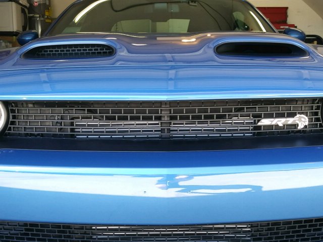

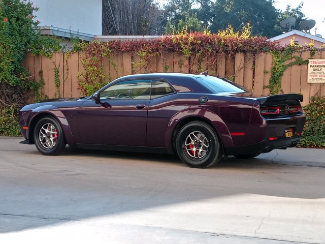

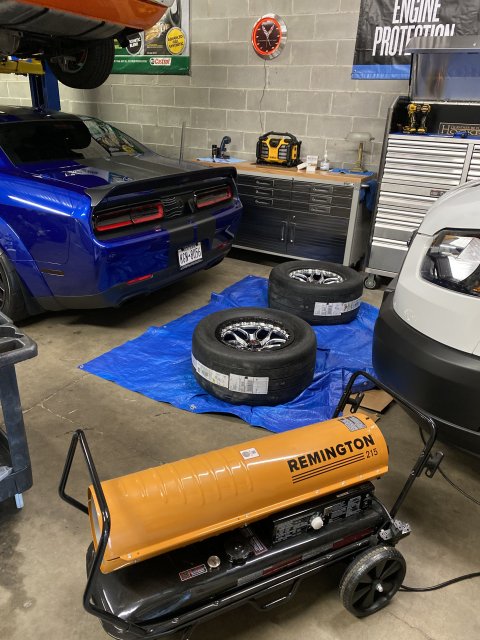

Just real careful prep including getting the car to hook and most of the easy to attain weight reduction bringing the car as close to a single seat Demon weight as I can.
Demon Air Filter, dry.
Removed Grille from Driver Side hood air scoop making it the same as a 2019 scoop.
Sonoco SS100 fuel.
Pass Seat (rear seat delete group as well), Sway Bar, washer fluid, floor mats and trunk center floor panel and accessories removed.
Light Weight Battery.
Deleted Pass mirror and installed SRT Performance Spoiler.
Light Weight Race Wheels & Tires.

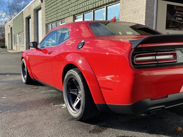

I just put the lighter wheels and tires on the car for my trip to Legion of Demons in Houston TX. I am also going to a private track rental on the 9th there (or in Ennis). I should see some negative DA and I hope the Car gets into the 9's. Right now the car has very little miles on it so I also expect it to get faster over time. It might not happen this year on this trip but I think the Car will go 9.85 one day. I know it is already faster than my Demon was on 808 tune and I am pretty sure @BeeHappy went 9.75 on the 808 tune in exceptional conditions. So theoretically it should be able to do the same. I do have a light weight Corbeau FX-1 Pro seat sitting there ready to put in, but I kind of lost interest in that for right now.
Here is a pic of the scoop cut out on my Frostbite car and a pic of the light weight race wheels and tires on the car now.
. View attachment 34790 View attachment 34791

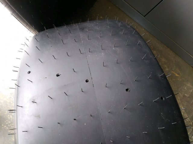

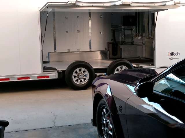

True story. I almost crashed loading the car in the trailer (slow speed). The Hoosiers with all those Tits on them would NOT go up the ramp. The car just literally would walk the ass end sideways like it was on ice. I tried it several times and it was freaky scary. Scratching my head, should I just try and "get a run at it"? Kind of risky with the tight fit in my Trailer............ Naw! Just back up and burn em off !!!!! NOW she sticks. Problem solved.
5,202
9,661
Ok I will see you there. I also paid for TJ's event on Saturday in Ennis, just in case.
. View attachment 34792
I had this problem with my trailer. When it happened to me and I went sideways, I damn near took my daughter's foot off. (She had her foot on the ramp!)
I solved it by buying this stuff and installing it.
https://www.amazon.com/gp/aw/d/B072LY8JNH/
Bonus was I installed it at just the right width and could use it to visually center the car by lining up the side of the tire with the edge of the material.

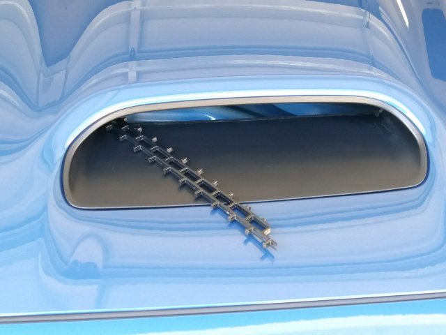

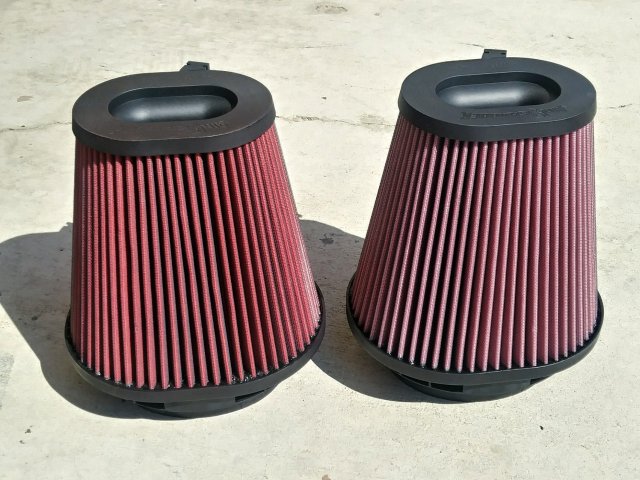

.DRAGRCR..How did you get the scoop vent out. Where would I get a Demon dry filter? Thanks for your help

@WidebodyCat I cut the scoop vent out with a Hack Saw Blade and then I finished off with a Dremel Tool. The Demon filter comes with oil on it. After you wash it and let it dry it will be white. I then dye it red to make it look like it has oil on it. You have to own a Demon to get that filter. Some have been able to get them otherwise but it is hit and miss. Just ask around in some threads and you may get one offered to you. Search for demon air filter threads and that may be a good place to start. Last pic shows a Demon Filter label and the next to last is a dyed Demon filter next to a new unaltered filter.
