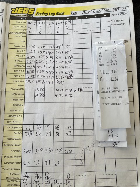

Mickey is the tire
Nothing goofy
With these.
I kept a log of every run for 4 years EE4EE899-A006-4598-9D16-7B4CCB67D6DD.jpeg
I can and try to predict the et before each pass.
I use a hand held weather station.

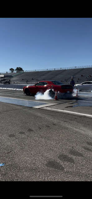

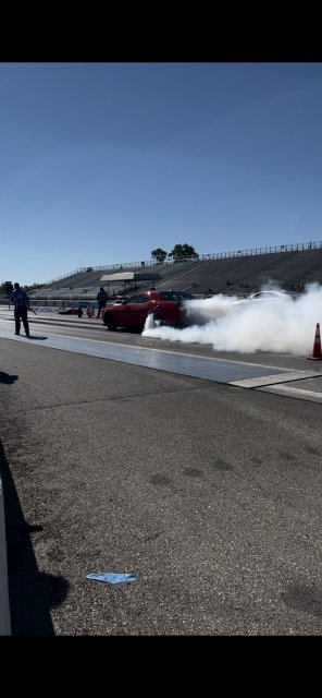

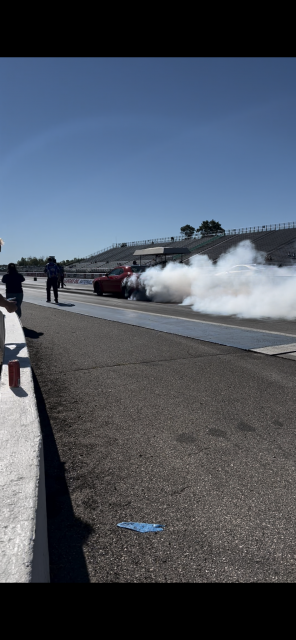

I will watch the
Clean up crew.
I try to gauge
When they are
Just about done.
So I can start the car
And let it run for a couple
Minutes before rolling back into the water.
I keep an eye on the IC temp
In the center cluster.
I log this number also.
When held up by officials
the power chiller
Will usually hold the IC number
Just make sure to keep the car running. 0D4B07D8-1C37-44C3-993E-9E3D2EDCCBD0.png
I was held up by officials on both these
Runs during a test and tune day.
It was hot so I only made two passes
About three hours apart.
I just keep it running.

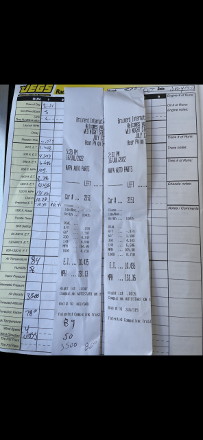

Mine is similiar

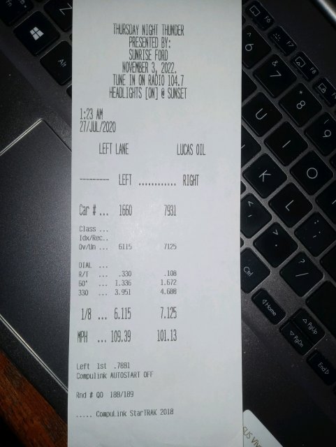

OK, So Irwindale was a blast this week. 1.5 hour delay when one guy oiled down the track 3 cars in front of me. I stood there the WHOLE time and watched them clean up. The fast cars run singles in the left. But the oil down was on the right. They rig sprayed the whole right and it looked amazing after the cleanup. I was planning on going in the right. Then the VERY NEXT CAR oiled down and crashed in the right lane. Everyone was freaked out because they thought the cleanup was insufficient and was the cause of the crash. I knew better. So, another 1+ hour delay. The motor got a really good cooldown. So it makes more power and the DA was heading D O W N. So they ran a bunch of slow shit just to prove the track out before they let the fast cars run. So we had to sit right by the water box while all these knuckleheads funneled around us and proceeded to jack the track surface up. So I DID take the right and the car did not make a good pass. All that waiting for nothing.......
But the DA went down to 100. Rare at Irwindale. So for my last pass I took the left. On this taller Hoosier and with fuel that could be a little better, the car busted out a 6.11 with a 1.33 sixty foot leaving at a conservative 1500 rpm. DANG, I will take that. Since it was so cold the car was wobbling on this pass and I am not 100% sure but I think it was running out of gas. Maybe sloshing fuel? The level was not THAT low. It was hard to tell, but I stayed in it because I KNEW the DA was killer. On better prep this car will be in the 6.0's when set on kill.
BTW, it will take a 6.06 to beat Nephtali's 9.504 in the Quarter Mile. I am coming for you......... In Huston I think I can do it.
BTW the MPH was almost 112 on that less than ideal pass before this. So this likely would have been 3 MPH higher or so.....

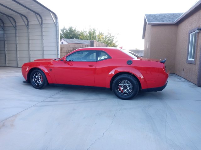

Car is set on Kill. Lets see how she will do tomorrow.........Sunny and 68 for a high........

Should be killer DA.

Sorry guys, I could not get it done. I was running Six Teens all night at 112. All runs were 112 and one pass was 6.206 with a big 1-2 hiccup. So, the track was not cooperating. Down track prep was not holding up. Probably because it had rained. They needed to rig spray the track again but it cost too much......The faster 2 of the 4 friends trailered their cars early. I kept at it, but never could take advantage of the good DA. With this car I do not get too excited if it hiccups. It's just track prep. I made 7 passes and it had a hiccup on 3 of them and on the last pass it ran 112.75 and it shifted from 1rst straight to 3rd gear. That hurts acceleration a bunch. Best pass was a 6.131 @ 112.41 WITH a sizable 2-3 hiccup.
There was a stranger prepping and starting the cars. He was doing some cool shit, but needed to dial in the down track prep. I hope I can get my Six Oh at Match Race Madness soon......
OK @Speedy! and others I have a question. The car does not seem to be able to 60 foot quite as good on this shorter tire 28.0 VS 29.5 and I am not sure why. I am using what I think is better fuel and the speeds are up accordingly etc. HERE is my theory. Is it sound? With the taller tire it gets to 60 feet before the 1-2 shift and the shorter tire does not? Is this logical or possible?

That's a good hypothesis. I know in my logs with the 2.62 gear and 305/45R17 tire I hit 42mph at the 1-2 shift. It's something I've looked at to get past the 60' before the first shift.
If you can have someone video your run and watch at the 60' cone maybe you can tell without a log.

Same tire, just different sizes?

Technically, yes. 28/10.5R17 VS 29.5/10.5R17. I think the 28 is actual 10.5 or 10.4 tread where as the 29.5 is underrated @ an actual 10.9 tread width. Yes both Hoosier DBR's.
Interesting note, on Thursday it was really cold and the 28" tall Hoosiers did not wobble once. The 29.5's do it at least once per track visit. The 28's have done it though. Just not this pair, yet. Hopefully in Houston they will not do it much if at all. Big Burnouts here we come!

What are the 60's you're averaging with the 28 vs 29.5?

Keep in mind it will vary with launch RPM. Most of these are at 1500 RPM. Which is not possible if the track prep is not real good.
Last runs with 29.5's and similar DA
1.336
1.349
28.0's
1.351
1.357
1.349
1.358
1.338 They prepped right in front of me so I went to 1800 on this one
1.341 1800
I am going to try both sets of tires in Houston when in neg DA.
Also when you look at the numbers it does not look that bad. But I was expecting more based on the conditions.
