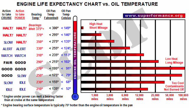

Not a Redeye, but I see in excess of 270 oil temp at the end of a 20 minute track session.
Never noticed the coolant temp doing that on startup, but I'll specifically look for it to see what mine does...
Watched mine today.
Went up steadily to 202, then dropped quickly to 195. Then settled in between 197-199. Ambient air around 65 - 70. Intake air temp between 95 - 100. Backroad gentile cruising....
