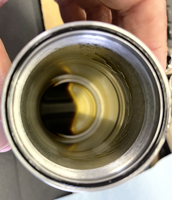

Satisfying the six month warranty requirement no matter how many miles...
I drove 1,442 miles between oil changes right at the six month point, of which about half was on road courses with lots of hard acceleration and some WOT on the long straights, and half highway and country road easy cruising between 1,500 and 2,500 RPM, mostly on the low side of that.
I estimate two teaspoons, which is .33 fluid ounces. 16 fluid ounces is a pint.
The Pennzoil Ultra Platinum oil was very dark. Here and in the drain pan.

If these vehicles required a catch can, MOPAR would install one, no?
The problem there is most would not check it. Which in time could lead to some issues.
Hell they can't even get people to check the oil on a regular basis.
17,013
53,316
#63
They DID install one.
Adding another one to improve upon what is there is the goal.
Keep in mind, the oil vapor in the pcv loop is the worst of the acidic vapor in the engine. Keeping more of it out is better.

I was looking at the Moroso can with the outlet on the bottom. Question: Could acidic oil and exhaust reentering the cylinders be partly responsible for lifter failure? i.e. HEMI tick.
Not in my humble opinion.
My 5.7 has it bad, obviously whole different engine.

Out of curiosity do you run Pennzoil? Some speculate Molybdenum helps quiet the tick. Curious if your oil has Moly (as main AW ingredient)?
17,013
53,316
#71
That vehicle has always run M1
I didn't know about the Moly until it was too late.
