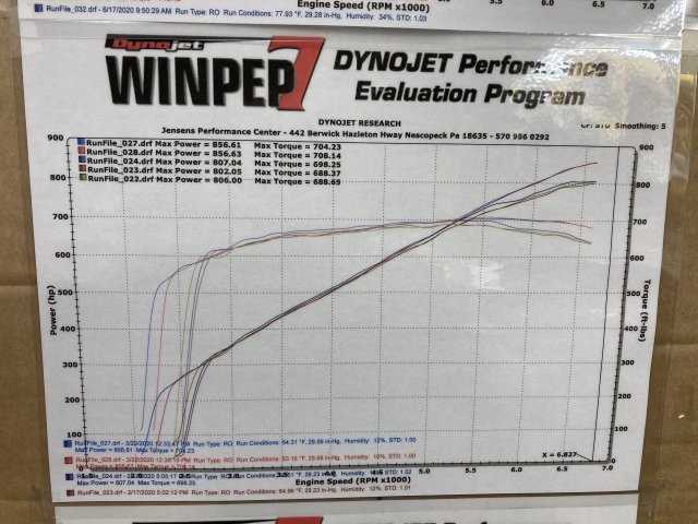

I used a FAS plate, ruined my original blower the first installation because the bearing bores where too tight. Gained a Dyno proven 50 hp with it though on the second blower, luckily I had a new spare blower in a crate on hand. This dyno graph is before plate and after plate. I also port matched image.jpg the stock snout to the plate and added a fast man true 95 mm throttlebody.
