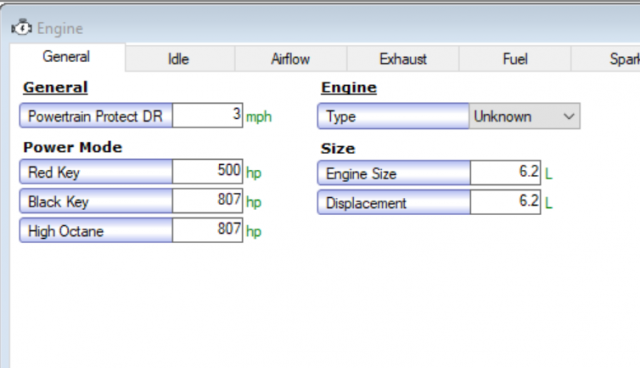

Got my bypass cable in today and read my stock tune...
What the heck is wrong with this picture??? Screenshot 2021-11-03 224526.png

Keys are backwards on power rating.
You be slow with that red key.

Screen says 807 HP with the red key... but why is it backwards in the tune?! The 2020 file I looked at was correct with red listed as 807 and black at 500. Weird...

Maybe you'll get lucky and it's 870 hp and not 807.

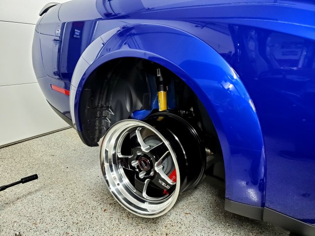

Test fitted my rear Welds tonight. There is only a finger width of space between the inside lip of the wheel and the sway bar, but guessing that should be ok. 20211111_182212~2[1035].jpg
