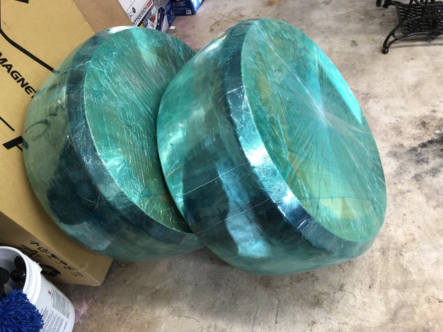

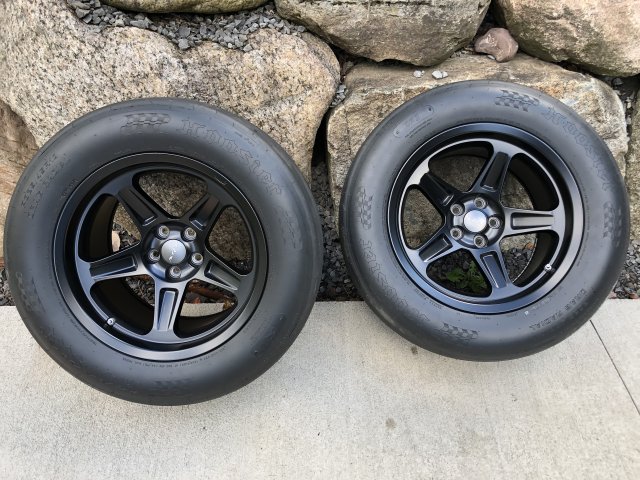

Those wheels and tires should be coming soon… BB7CDCF2-8089-48DB-939D-7A0386977353.jpeg BB7CDCF2-8089-48DB-939D-7A0386977353.jpeg 433A469A-9E19-4FAB-86FD-49309D110A85.jpeg

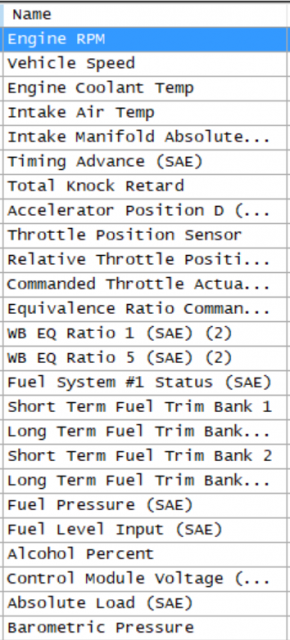

I am just datalogging for now, which so far is working fine without the bypass cable. I haven't changed any of the PIDS yet, but the default one has knock retard. I'm sure IDC can be added as well, but I'll figure that out shortly since I want to set up a custom set of parameters to log.
Here are the defaults that were already set up (except for ambient air temp which is at the bottom): Screenshot 2021-09-20 222956.png

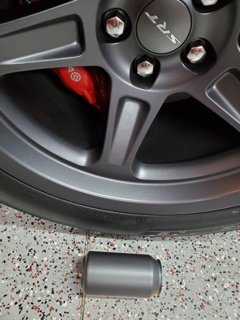

So while I'm waiting on my backordered Weld 17x10 rears, I found a set of Demon wheels from a forum member. Was trying to figure out how to get the Demon wheels powdercoated to match my Super Stock wheels (granite gray) but think I may have found a "quick fix" to go racing and have a close match. I remembered I had some anthracite gray plastidip on the shelf from years ago so I went to check. Found a test subject (aluminum can) and these are the results. It is so close that I don't think anyone would even notice! I will give that a try and if I don't like it, I can peel it off. 20210922_190652[560].jpg

I'd call that a match.
Run with it.
We need numbers!

Nice match on the Plastidip!

Just because the PID appears, does not mean it will populate with data from the car. I was unable to log those channels on a locked pcm with my mpv1

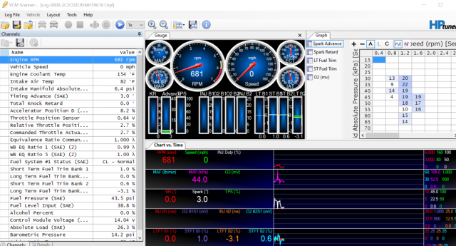

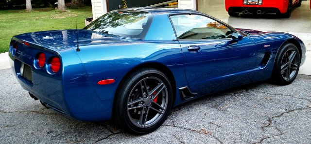

Here's a picture of what I last used the anthracite gray plastidip on... These wheels on my 2003 Z06 were "hyper silver" which appeared to look like polished aluminum and I didn't like it. So I put the anthracite gray plastidip on them and this is how it turned out: IMG_20150831_222828.jpg

based on your screen shot, you do not appear to be logging IDC or TPS...as there would be a numeric value there if you were...
You originally asked about knock retard and IDC, and I said knock retard is logging fine (as you can see). I haven't had time to figure out injector duty cycle yet, but I understand it can be done as a math calculation using injector pulse width since there is no actual PID for IDC. My main concern is datalogging since I'm not tuning this car anytime soon, and so far it looks like it's going to work great.
