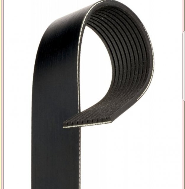

Anybody use the Gates high performance?
Racing Micro-V High Performance V-Ribbed Belt; Black
Racing, Performance, Muscle. The only belt in the industry specifically designed for high-output and forced induction engines. Specially-engineered to deliver maximum boost and performance, these belts feature the most advanced technology.

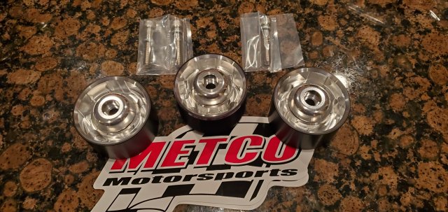

Rick at Metco was awesome. Answered all my questions and concerns. There is another pulley "manufacture" that many have used as well but according to Rick, "The fact that the XXX versions of these pulleys look just like ours is because XXX copied our design. We have no affiliation with XXX, whatsoever, and after seeing ‘their’ pulleys, I question their business practices."
I guess that's what patents on inventions are for. Keeps your competition honest.
I'm hoping the heat /friction will be less than the heavy OEM pulleys that take considerably more effort to spin. Not sure when they get up to operating temp if that changes. Plus I like the idea of having better dual, higher rpm bearings.

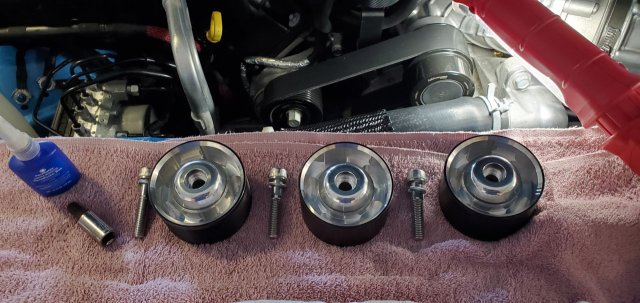

I added an additional idler pulley to replace all 3 pulleys for the blower belt. The only reason they don't offer a kit with all 3 is because they have yet to remove the lower idler to verify fitment. I'll be sending him pics to verify fitment. Others have used the same idler for both locations so it "should" be fine.

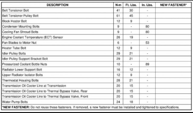

Anyone have the torque specs on these pulleys? I'm thinking 21-22 ftlbs. I remember seeing or hearing that on some of the vids but I'm not 100% sure.
I haven't heard anything about this one. Seems like Hpindy likes the Gates Gold belt but I haven't compared the two. At least we have options. Just need to find the happy place for the pulley bearings, rotor bearings and which belt fits the bill without the premature wear like the Bandos.

Great looking pieces. I'll install in the morning. Found this tq spec sheet too.

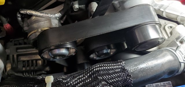

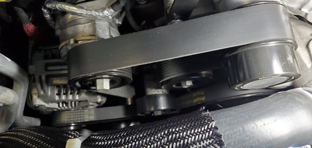

So the fun begins...wasn't too bad actually. Just a bit tight with both idler pulleys and not able to get my hex bit socket/tq wrench in there with the fan shroud. Relied on 38 year inner tq wrench...lol
No issues with adding Metco lower idler pulley. Seems to be same as the upper idler. A bit closer to the accessory belt but everything else seems fine.
Before and after...

So the fun begins...wasn't too bad actually. Just a bit tight and not able to get my hex bit socket/tq wrench in there with the fan shroud. Relied on 38 year inner tq wrench...lol
Before and after...
Looks good. So you left the tensioner pulley stock?

Thread Starter #36
No...tensioner and both idler pulleys swapped. See in 1st pic the 3 pulleys laid out. The before and after pic shows the difference in the OEM and Metco tensioner pulley.
Got yah. It was just hard to see the grooves on the metco tensioner pulley on my phone..

Are they the same size as oem? Does that mean the lower idler is bigger giving more wrap on the crank pulley?

Thread Starter #39
Same diameter as OEM so no additional belt wrap. Slightly wider but that's it.
