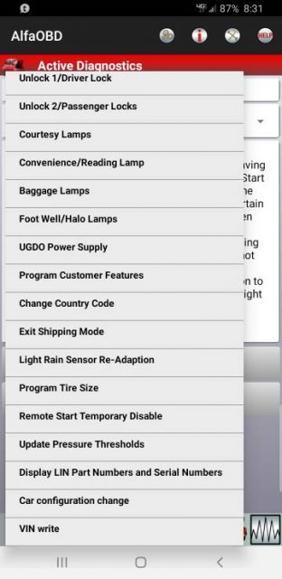

Here is a list if things you can put into TEST mode, to verify proper function.
This list will vary, depending on your model year and vehicle, but this will give you an idea of ONE of the things Alfa can do.

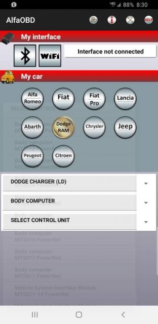

Launch AlfaOBD and choose DODGE/RAM, CHRYSLER, or JEEP. Click the bluetooth button and select your bluetooth OBD client, from the list.
Select your vehicle.

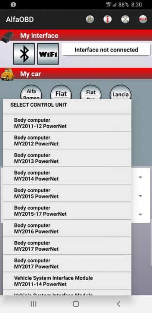

Select BODY COMPUTER.
Tap SELECT CONTROL UNIT and choose your MY Powernet.

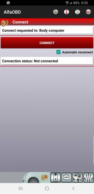

Click CONNECT

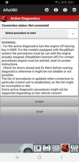

Click SELECT PROCEDURE TO START

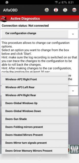

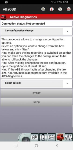

From the drop down, select CAR CONFIGURATION CHANGE
Click SELECT OPTION
Scroll down to DOORS - GLOBAL WINDOWS DOWN
tapatalk_1567400575761.jpeg Select YES and click START once. In the information box, at the top, the current car configuration will appear. It will tell you if your car is set YES, or NO, or whatever variable you can choose from.
Click CONTINUE and wait. Alfa will tell you something like PROCEDURE COMPLETE and you can close the program and turn off the key, or push the start button to the OFF position.
Remove your OBD client.
Grab your FOBIK and try it out!
Enjoy!
NOTE: GLOBAL UP has not been figured out, yet. If you do figure this out, please post it up. Even if selected YES, the windows will not roll back up. If you have a pre 13 LX, what is the FOB routine, to roll the windows back up? Maybe it does work and we just don't know the windows up dance.

In Alfa, select:
Dodge Charger (LD)
Body Computer
Select your Model Year (MY...)
Click: CONNECT
Click: SELECT PROCEDURE TO START
Click: CAR CONFIGURATION CHANGE
Click: SELECT OPTION

I did the global window down on my 2015 and it works great.

I tried the Global windows up on my 2015 with no joy.
Diboblo
Diboblo
#1044
7,309
33,754
Riverside
2015 Dodge Charger Hellcat!
Yeah, I set up and down. Up... no joy.
This is a known issue, but the damned Tazer does it... so it IS possible.
I know Alexie has a lot on his plate. Maybe this will become active, in later updates...
