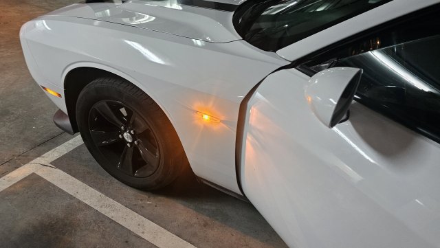

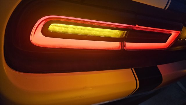

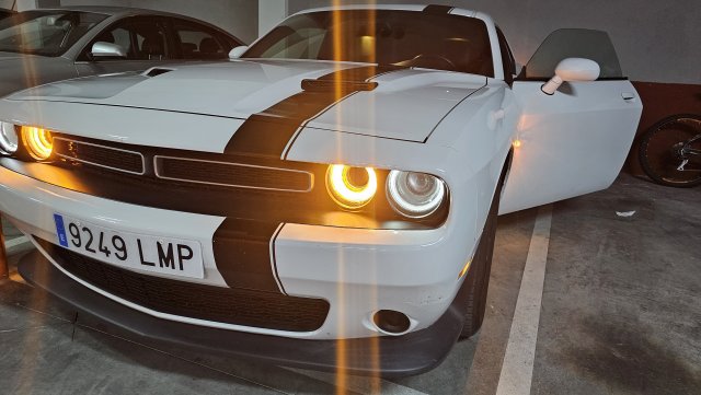

Hi guys, greetings from Spain. I have a 2016 Challenger Sxt. The ambar DRL are no "legal" here so the car comes with the white ones as standard. Anyway, I buy the Veepeak OBD and Alphaobd, see a few videos and try to change it to the ambar DRL, in the value "Drl lamp location" i set it in turn signals, but now i have the ambar halos + side turn signals + back turn signals ON all the time, i only wanted halos. In the screen i selected DRL OFF and now its all off but i really want the ambar halos. Anyone knows what can be happening? 20241208_153402.jpg 20241208_153407.jpg 20241208_153414.jpg
