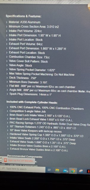

SWEET!! LOVE those valve covers!!
What size valves they put in them?
224 cc intake
64cc exhaust

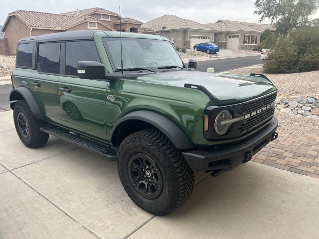

I now have a ford and am slow! Lol
