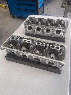

Mechanic states they are very pretty!

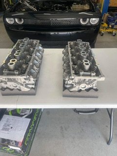

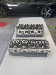

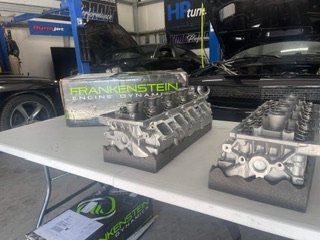

Frankenstein stage two fully assembled with slightly larger intake valves. Once together it will get dyno tuned remotely on my mechanics dyno.

I went back through the thread and saw they are ported. Heck I was thinking you had one of the AFR heads
