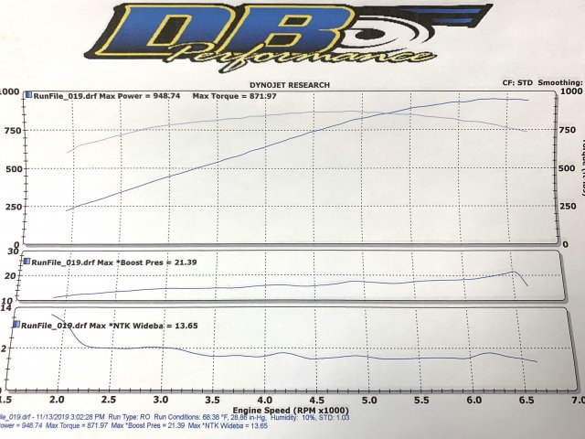

It’s been a long 6 months but my car is finally home! Unfortunately, the driving and testing season is long gone but I’m happy with the base results. To start out, we’re going conservative using 15* of timing on pump E75 using a 4” (21psi) pulley. Nothing record breaking but we’ll start here for spring time and ramp it up as needed. I still have some plans so stay tuned for more!
Here are both STD and SAE dyno sheets and short little video:

Awesome, thing will be a monster on full tilt lol

Nice build. That thing needs more boost. You could still street that thing at 1100 whp. Turn it up lol.
