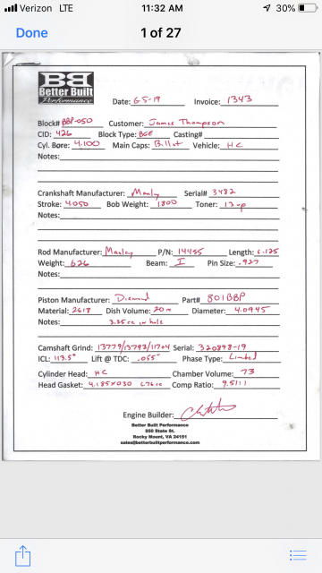

This is my build sheet. Shift point is at 6400 rpm I believe. Tim Barth is the tuner.

Lol this is mostly a street set up so I really don’t need any mor HP. I need more air so I gotta upgrade my SC next summer.

My engine builder Alex at BBP was surprised to see those numbers in that heat index on a stock blower.
I’m tempted to order a KB SC right now... lol

You’ve got an awesome build! I’ve listened to your cam videos about 100 times! Love that sound!
