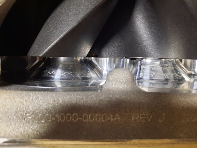

A 3.0? Be curious to know what Rev they’re on now. Please post picture of it, it’s on the back edge on top by rotor discharge. Last one I saw was a Rev J.
is this it?
61,169
213,787
It is towards the back may have been on the inside. Will be a letter mine was J
same here rev J
