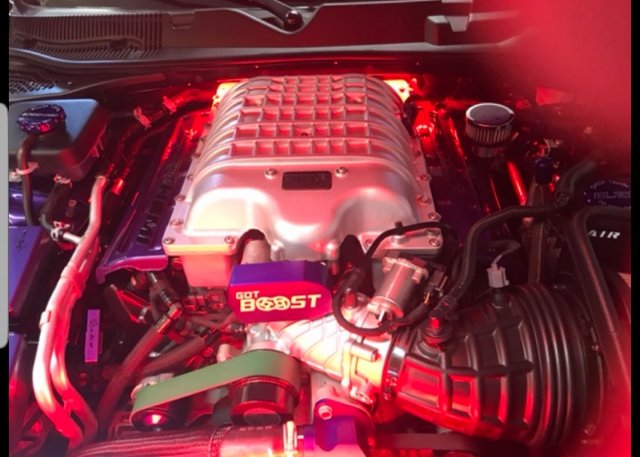

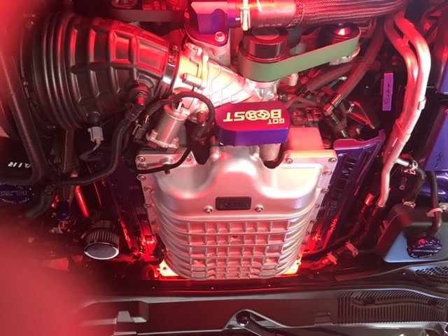

I put a 180 in stock Redeye with not issues. While at it I replaced the thermostat housing. 564EDFA2-37B5-4A5B-9FF1-12A6354C1A11.jpeg

Now that the pic is flipped the coolant will drain out when you change the thermostat. I like the less messy vertical method better.
