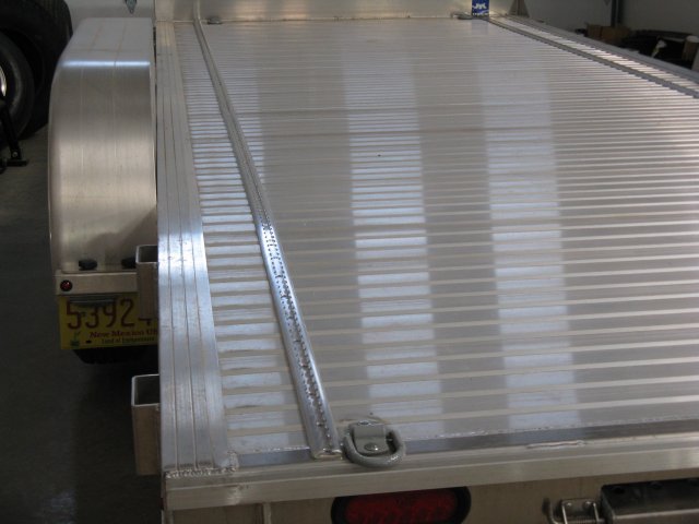

On this trailer there are crossmembers every 12 inches, and the extruded floor panels are fairly stout, too. That allowed me to use two bolts per foot, then rivets in the holes between them. No need for backing plates in this case. DSCN2672.JPG

Unfortunately, trailer decking (be it wood or steel) is usually very poorly secured. Enough to keep it in place, but generally not much more. You probably need to tie into the cross members.
