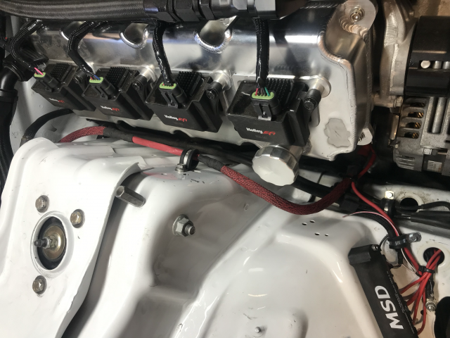

Well… 🫤. I guess I’ll put the results here. At Famoso trying to get dialed for Houston next month. First pass was with 18* timing to get some safe data. This was the first 1/4 mile pass on the new build. 8.44 at 161 mph. Decision was made to just drive it off the line off the foot brake and raised the bars up high for a soft leave. That was a mistake. Carried the fronts until the second gear shift at about 100 ft. (See pic). Tripped the 60’ with the rear wheels at a 1.24. Things went down hill from there. The mph kept going down and it was obvious that something was wrong. Turns out a o-ring in the Holly valve cover failed and was oiling the plugs on the left rear cylinder causing a misfire. We now have a dead coil pack. These are the Holley EFI coils so it’s doubtful we’ll score another one for tomorrow. Oh well ☹️ View attachment 89449
That why I’m still in stock valve covers every has had issue with the aftermarket ones
I'm running the Holley EFI coils. They don't fit on the stock covers. I went to those coils for the new motor we're building. It will be a very aggressive 11:1 comp. 30 lb 3.8 Whipple monster. The higher voltage coils 'should' be a benefit with that motor. Also the fab covers have the room for the aftermarket rocker setups (we're using T&D) and make pulling plugs easy. Other than that... they suck lol tempImagev98JQ1.png

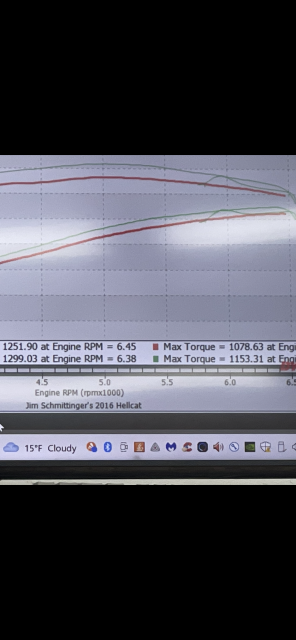

Put my car on Dyno getting ready checking fuel system. All is looking ok. Made 1126 on a 3.0 upper 10% lower at 18 degrees running it till 6300. Going to put on a 2.75 tonight and let it eat a little.
I tried to get you to run it out till 7k :sneaky:
We can let it eat tonight. Need to make sure trans won’t let it shift

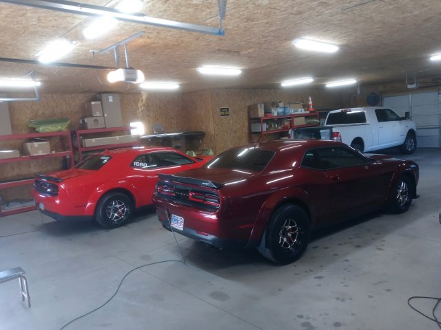

These Two are ready to race at Legions. Just finished the (re) build on my friends car and got it all detailed top and bottom, pullied, tuned/tested weight reduction, new wheels tires etc etc....... He picks it up tomorrow. It's a great Car, no issues.

That's awesome Ron. Those 2 cars are well ahead of mine right now.
Btw, what size is your garage? I think I'll be building a new one sometime next year and yours seems like a great size.
It's a T shape. 60'X30' and 40' wide on the T. Not sure why he did it that way. Ceiling is 10' and has 8X16' doors on each end.
