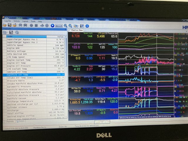

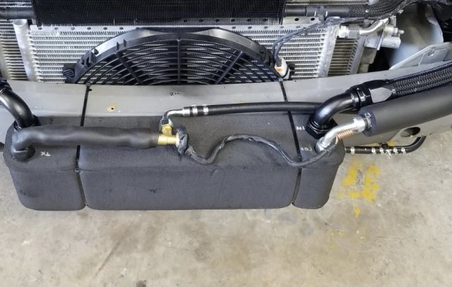

AKA.. The Dead Sea Scrolls 😂. That was back when we were facing off with 185 mph pulls on the Gila Bend Half Mile and trying to keep those 4.5’s cool. 615868CC-3967-4B70-BE87-C142075BA5D1.jpeg

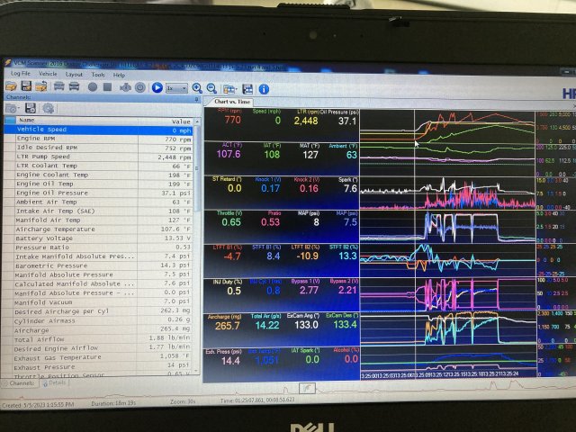

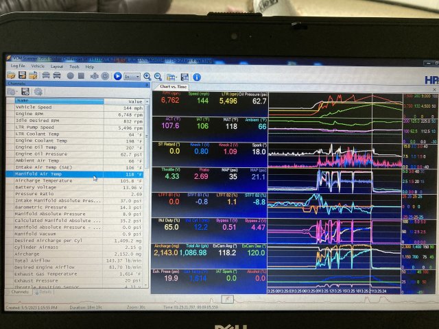

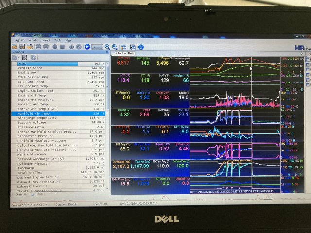

Here’s the 3.0 back to back 1/4 runs last month
D43C24B1-E6AC-414E-B5C9-BF5EA584D656.jpeg BBD6286F-9206-47EC-9BDF-7DD3BA06EBDA.jpeg 829D9768-C267-4A76-B377-2ACCA3FBBCBF.jpeg 77578986-9199-450B-8659-C5D5F73119B5.jpeg

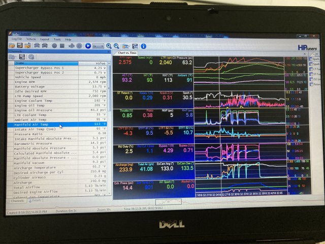

Here’s the 2.4 2.72/+10 combo, yea, it got IAT timing pull hot by the end of the 1/4 but it was 90 F ambient that day
1F8F87B8-6EA5-46F4-9F4A-711F9DDB771E.jpeg AB79EA4B-29F7-4EC5-8D89-0399D709F15E.jpeg
I only run E80-85, no more 93 for me so the Whipple fits the bill but Whipples start rattling wayyyy too often.
