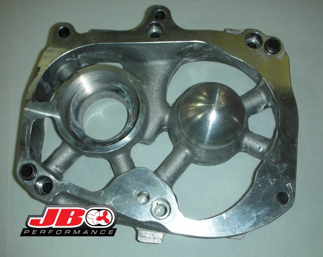

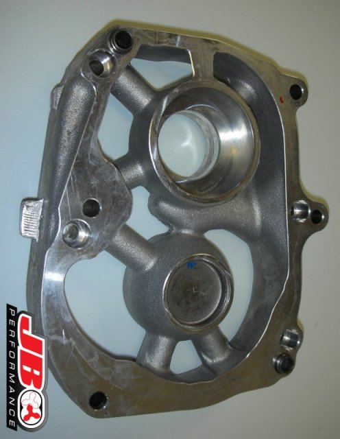

This, The legs that support the bearing housings, look like legs from a spider, to me at least lol 4FBC3D9F-1084-4767-93D7-860C8609FD52.jpeg
3,635
8,546

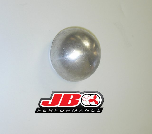

This smoothing blending and air-foiling of the obstructions in the air path let’s the blower breath more which means more boost without spinning it any faster, good for 3040 hp I’ve heard. I want to do that to my blower, even just adding the cone cover over the flat bearing plug is good for some boost
3,635
8,546
Stock bearing cover plug looks like this, they sell this cap to help blend air flow over it
