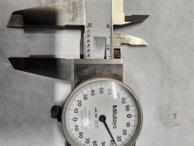

Threaded part of screw measure out to slightly over 16mm. I checked it with the depth gauge part of the calipers but couldn't hold it all and take the pic at the same time.

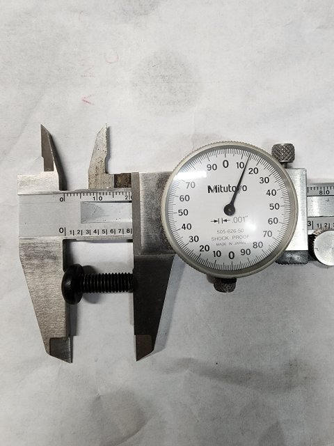

OAL of screw measures out to almost 21mm

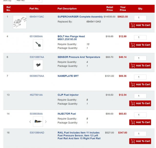

yeah, I looked them up too, they would be #10 on this diagram ...
and guess what is conveniently missing, skipping from #7 to #13 ...
That's what I found on eastcoastmoparts and another site as well.

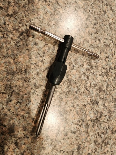

Then, using this
I chased the tapped hole. Screw goes in fine, a little loose at the beginning, due to lost material, I'd assume, then gets tighter.
