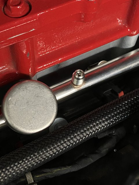

Nice thing on the Redeye, there's already a AN4 schrader valve there. Got a hose from a fuel pressure tester pigtail with the AN4 and schrader depress on one connection, 1/4 NPT on the other, then a 3' hose with 1/4 NPT for draining. Have a relay switch to pop into the fuse block to control the on/off. Pumps out the fuel in about 5 mins for an easy change between 93 and HO and back at the track. I believe the fuel rail is interchangeable, change out with a redeye one is another option - of course could cost more.

You can see it on the rail in your wtb thread @BULL

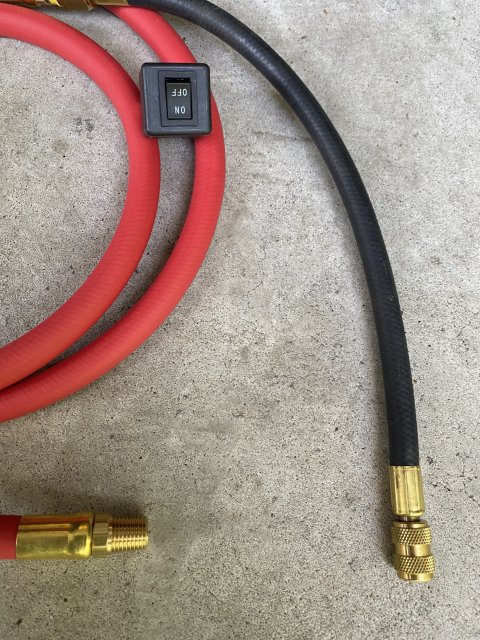

here’s the schrader under the fuel rail cover on driver side, along with the hoses and relay switch. Hook it up, pop in the relay switch, turn it on and it pumps out half a tank a little over five mins or so. 96311DEC-690A-4B5D-B27D-E811DA0382C6.jpeg 581A4F58-98B9-4B1E-9A44-FE8C7DB0FADB.jpeg

here’s the schrader under the fuel rail cover on driver side, along with the hoses and relay switch. Hook it up, pop in the relay switch, turn it on and it pumps out half a tank a little over five mins or so. View attachment 41112 View attachment 41113
Well I'll be damned...
Awesome, and thank you!
