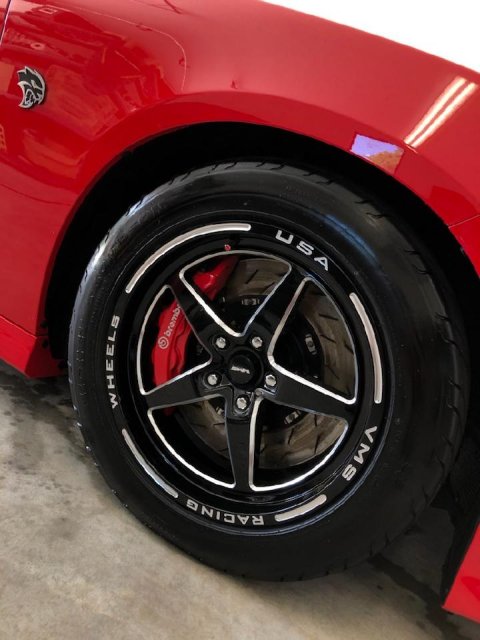

2020 hcwb....Driving above or below 85 and the vibration/pulse is gone. 85mph and you feel the vibration through the steering wheel, brake and gas pedals and the floor boards.
Tire balance?
Driveshaft?
Any thoughts appreciated. Has nitto slicks on the back and stock tires on the front.

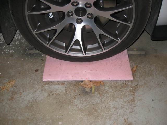

Good old flat spots.
The easy solution to flat spots is get some 1/2" thick pink foam sheet insulation and cut squares to park on.

I have to wonder if the DR's are cold and unhappy, or maybe they moved on the wheel. Did you mark the wheel and tire when you installed them?
Mine definitely move. They were marked and the detail guy rubbed them off with tire shine.
They'll need to be rebalanced after this next event.
